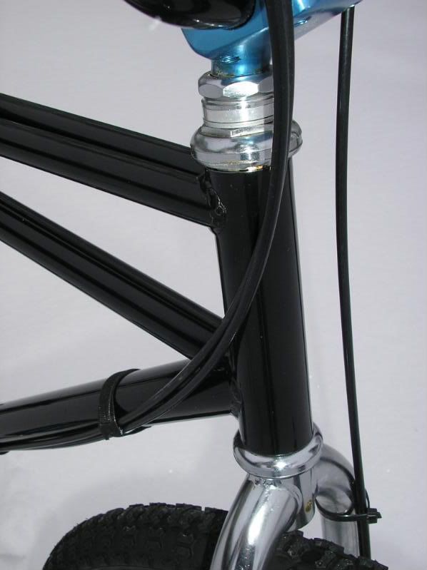

I'm going to be running 2 cables down the down tube for an IGH and a drum brake...
1) Zip ties
2) Stick-on guide
3) Old road tandem cable clamps
4) other
Example stick on guide from jagwire

zips or sticks are acceptible - hose clamps work too ;)
DX has stick ons
my now sold Nexus bike had stick ons with zips to hold the extra cable
Those Jagwire stick-ons work great and are a very clean solution to routing cables on a bike that wasn't built with cable braze-ons. I used them on my old chopper/cruiser project a few years back.
To me, it all depends on how you are building your bike. I would say that zip ties or hose clamps are more in the true spirit of the late 70s. If you are building a very nice, polished looking ride, go for the stick-ons.
Road bike cable clamps work and add a touch of class. Period correct too if that's your thing.

#4 aka Backstops if you want to leave cables open. If not you should be able to find the TT brake cable metal guides to holds full length housing.
Road cable clamps look the best to me...
Ditto
Modern creative thought would suggest little black stick ons' that take cable ties - they may need to be glued on with some clear E6000 glue. You may find they don't work everywhere and then you're stuck with cable ties - eventually you may find that cable ties are good enough ! What happens when a little black glue on is needed in the middle of your nice paint ? I've used both...

Thanks Alan, Which brand of stick-on do you typically use? And thanks for the tip on the extra glue.
A good look, but 1" doubles seem pretty rare. I'll have to see what I can find a the swap meets.
Duh, whatever you can find. I think maybe I used some avids and/or jagwires They are rectangular. On the hybrids where there are three cables on the downtube I use the zip ties to keep the clutter down and speartips clear. BITD we used zip ties. Love that orange bike !
