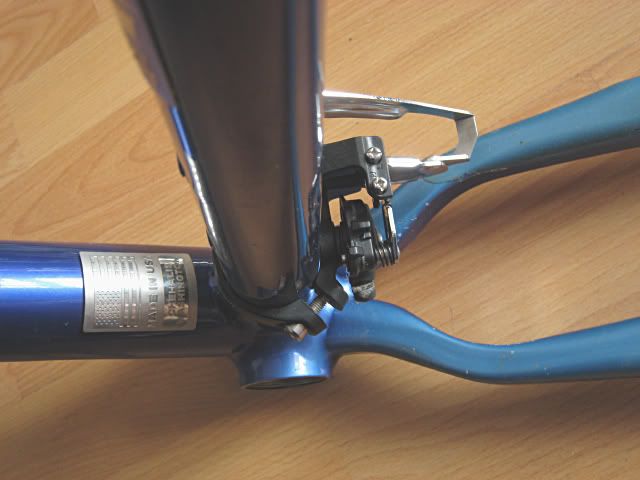

Here's a photo attached. I'm sorry for it's poor quality, my neighbour's pinched my proper camera for a couple of days.
Thanks,

As stated previously, just squeeze together both ends of the band firmly and try to initiated turning of the bolt until it bites.
I don't have a FD-M970 at hand, but here you can see a FD-M530 loosely fitted with about 2-3mm of thread engaged by the bolt and already the band is difficult to squeeze together:
Properly torqued (hand tight, then just a little bit more), a few mm of the bolt thread will protrude from the other side of the band.
I've just tried it again. I think it will go with a bit of persuasion.
Thanks a lot for this. Embarrassingly, it appears that I've been a bit of a ***** in not wanting to scratch the paint, but it seems that the paint is a fair amount tougher than I'd originally thought and the mech will actually go on....
Yeah, don't worry about the paintjob - it's pretty tough and won't scratch easily just from derailleur clamping.
And yes, you're going to need to persuade it here. Looks like the custom paint may be a touch out of tolerance so you're going to have to squeeze it on.
