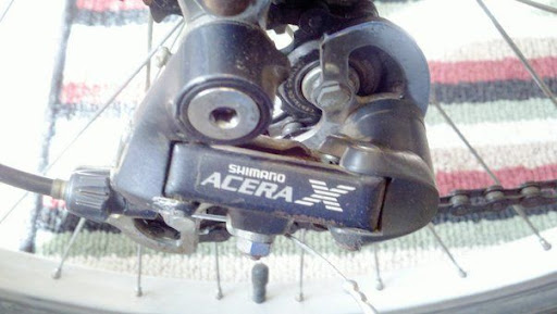

So, I thought I'd post some photos of my new wheels. The frame is good, no rust or cracks or bends and it handles really well. I think I need new tires, though. The tires on the bike are, I'm pretty sure, the original Kenda tires that came with the bike and there are some deep striations, not tears, on them, and it makes me nervous. Also, the shifting feels a little sloppy, not as smooth as I'd have hoped. Is this usual/normal for the "grip shift" systems? Or is it because it's been used and abused? Aside from upgrading to a lever system (and I'm not even sure it would be worth it to upgrade this 30 dollar bike, lol) is there something I can do to smooth the shifting out? It just a had a tune up from a great shop, so I know that's probably not the issue. Sorry for the wall of text and noob questions. Appreciate any feedback!
Here's the bike:

curious- how tall are you and what size is that frame? judging by the lowered top tube, it's a lady's bike (which might suit you if you're a lady) and, by the look of the components, was not designed for much more than bike paths and gravel roads. it has a 3x7 drivetrain, plastic brake lever, cheap twist shifters, a nutted axle, a freewheel, and canti brakes. all of this stuff is very outdated and not designed for the kind of abuse that trail riding will provide. I would be hesitant to take that on any kind of technical single track. you will be walking home.
it would not be worth the effort to go tubeless on this bike. I would bet that this bike has single-walled rims, which will NOT hold up for long on trails, and it will be very difficult to set up a single-wall rim tubeless.

It doesn't look a very used bike to me, if those are original tires they don't have much wear, the sprockets look good, it looks like you got a great price for $30. I'd say ride it, don't put alot of money in it, save it for a back up/loaner when its time to upgrade to a newer bike, you've already gotten your moneys worth out of that bike.
Maybe some new tires, put a guage on the chain to see if its ok, get some trail tools, spare tube, pump, etc, read stickys above, riding gear, Zinn & the art of Mountain Bike Maintenance book, and Happy Trails
