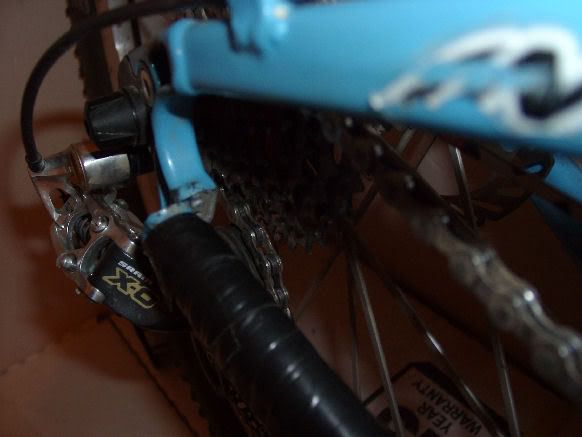

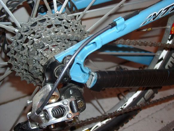

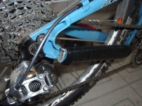

i was cruising down an easy fire road after an hour or so of hard trail riding when .....POP..... followed by buzzing tire. :madmax: after walking a mile or so back to truck in bike shoes:rolleyes: called intense, was informed that they dont deal with customers unless its warrantable damage (of course my frame is just out of warranty) so i have to try and get a replacement from one of the non-intense dealers in my area:madman: but no appology or even any concern about my safety from intense. this is sad to because i really liked this bike, but now am considering buying a yeti asl and fixing the intense and dumping it on ebay.
a side question to you downhill and freeride guys.... if you had a frame crack like this would you question riding it again, assuming you got it fixed?? if my frame had broken earlier when i was on harder trail i could have been seriously injured, and to top it off i would have been miles from any access roads. i mean if it broke that easily on an easy fire road, i have a hard time trusting it while blasting downhill. i guess it could just be a fluke, but if it happened once im sure it could happen again. and although i have good insurance, i dont really want to use it ya know:skep:

The frame is a 2006. Don't know how many miles since I bought it used. I have only had it 3 months. Mainly aggressive XC riding, no big drops or jumps, just fast trail riding.

" i mean if it broke that easily on an easy fire road, i have a hard time trusting it while blasting downhill."
To be completely honest, your bike probably didn't break that easily on an easy fire road. Usually when you see this type of break, the weld has been cracked for sometime and finally fatigues at a later point in time. If you look very, very closely at the break, some of it will look "new" and crystalized, where another portion will be smoother and darker. That indicates that the break has been widening for a bit. It's hard to tell in your pics.
It is a bummer that you're out of warranty and a 2nd owner on the bike. I'd consider buying a rear triangle and riding the hell out of it.
My guess is that the 1st owner rode the bike pretty hard.

i look at the break again i could seen any obvious difference in the material, so my guess would be that the crack is fairly new. i usually ride 5-6 times a week 15-30 miles a trip. trails are a mix of fire roads, rolling hills, rock gardens, and thick and rough root systems. i also did a couple of xc races this year. i gotta figure if this bike had a crack when i got it, it would have went sooner. anyway im no metalugical expert so who knows, but i just dont want to buy a new triangle to have it break when i am on a rocky downhill section and break my collar bone or leg or worse. i'd just as soon buy a new frame and forget all about intense. a $1600 new frame is just a bit more expensive than my major medical deductable

that SHOULD read i looked at the break again and i could'nt see any obvious difference in material
Man, sorry to hear that DominicSC. Sometimes those things just happen, but are rare. If it's any consolation, a few of my buddies here are on Spider XVPs and Spider 29ers and are literally beating the crap out of them (you should see the riding that my 29er sees). I'd chalk that up to freak occurance that would normally be covered under warranty for the original owner in the time frame. I still would feel good about a new rear tri.

hmmm. usually when a frame breaks right at the weld, the manufacturer will consider that as a manufacturing defect. however being the second owner doesn't help you in your warranty claim. i doubt that u can "fix" that. you'll need a new rear triangle for sure. how about really asking the Intense guys nicely. You never know.
it's obvious that the failure didn't happen on the stresses from you riding the fire road or else it would have broken on the rock garden or "hard trail riding" you mentioned instead. It just happened and finally gave up on that road.
