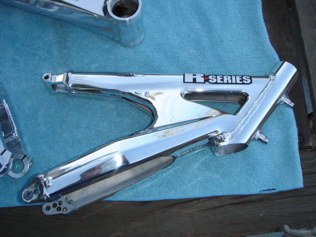

I started with raw frames right after heat treatment and alignment. I was able to get them at under half price that way. I used 0000 steelwool and wet sanded. The 0000 actually gives it a nice satin finish. I always wet sand so there is no dust, and it gives a more even finish, and the paper can bend aroung curves better. I also let the paper soak in water over night before sanding. Be sure to always wear gloves what will keep the Aluminum off your hands. Then I do the same with 500, 1000, 1500 and then 2000 grit paper from an automotive paint supply store. The paper is pretty cheap, like fitty cent a sheet. The 2000 grit paper will actually leave a very dull looking finish. Then I hit it with the Mothers! The Mothers makes it shine like a mirror. 2000 grit can be used to take out clear coat scatches in your car paint, if you know what your doing. They had finer paper, I think it was 3000, I was going to buy some, but they only sold it in packs and it was about $30, so I didn't buy it. I can only imagine what 3000 would make it look like! I tried the buffing method with pads and an angle grinder and compounds. I had absolutely no luck doing it that way, and it was very messy, spatter all over the place. Polishing by hand is not hard if you know how to do it. It is time consuming. But come on, most of us could spend an hour a day less on the couch for 3 or 4 weeks.
Here is another frame I did. It's been a couple years since I touched it up and it needs it really bad.
Mountain Cycle Shawn said:
Did you also know that polishing will help prevent metal from cracking!
Really? I had no idea, learn something new everyday ;)
That Mountain Cycle is like a mirror man, nice work!
Those do look great. I have used sandpaper on my stuff in the past as well to remove scratches before buffing. That wet sand paper at 2000 is almost smooth enough to wash your face with.
