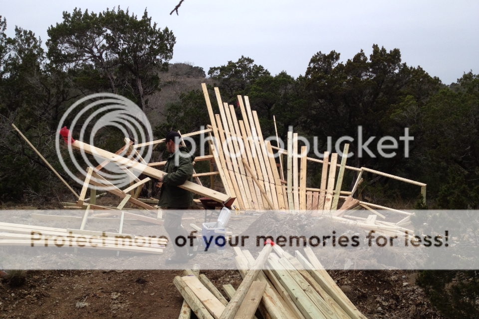

Straight lumber can be used to approximate a curve with multiple stringers joined at posts/piers aligned radially from a center point. You'll need 5-6 piers per 90deg of turn arc to make a pretty smooth transition between sections of decking but you'll never completely get rid of the transitions. More piers gets closer to approximating a true curve but with diminishing returns and much more labor. There are many images showing the framing layout for these structures out there if you image search for "wood berm framing". Making a small model out of craft wood & hot glue can help visualize how it all fits together as well.
This is one of the simplest 2x wood berm framing methods I've seen:
I designed/helped build three curved wooden berms a few years ago and we used resawn treated 2x4 material to laminate curved beams for the deck attachment structure and steam bent oak boards for the decking. Tons of work, but as close to a curved berm as you can get.
More images from the project here.
Shaky POV video from this section of trail here.

I haven't seen many others but I'm sure they are out there. There is another curved berm in Copper Harbor, MI on the Overflow trail (one of the inspirations for our project actually). It looks like the Mammoth berm might use composite lumber (HDPE plastic + wood fibers). That stuff is really flexible and can be formed into a pretty tight radius by heating. It isn't very strong though and they warn to not use it for structural applications. We considered using it as decking but felt it would be too slick when wet and too flexy. It's also expensive (~$3 ln.ft.)
