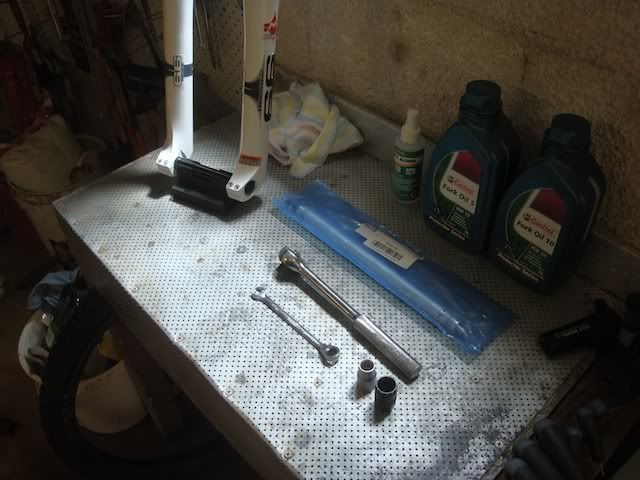

First, your gonna wanna gather some tools and parts;
Tools:
(Note: these tools are for a 66 RC2X, some may differ with other variants of the fork)
- 10mm spanner
- Cassette lockring tool
- 12mm socket
- 4mm socket
- Multi grips
- Rags
- Isopropyl Alcohol
- Measuring Jug
Parts
- 7.5 wt quality suspension oil, i use a 50/50 blend of Castrol 5wt and 10wt

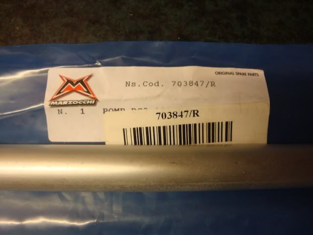

- Marzocchi RC3 Damper
Now this can be the tricky bit, you can get one from a broken donor 08/09 66 or you will have to order it from Marzocchi, i ordered mine from the Aussie Importer, $165 and it was at my door in 2 days, thanks Brad at SCV!!!
The part number for the Cart is 703847/R

Right, now that you have collected all your bits, lay everything out on a nice clean work area
Heres a pic of the Cart, showing its Part number

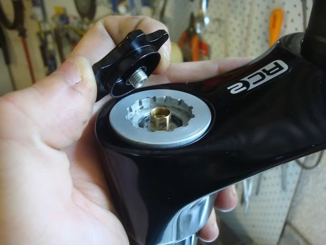

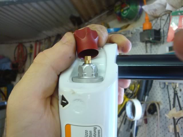

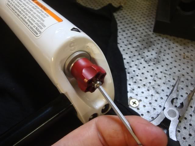

Back off adjustments on both Rebound and Compression, then remove the Rebound and Compression adjuster, put them aside in a safe place.

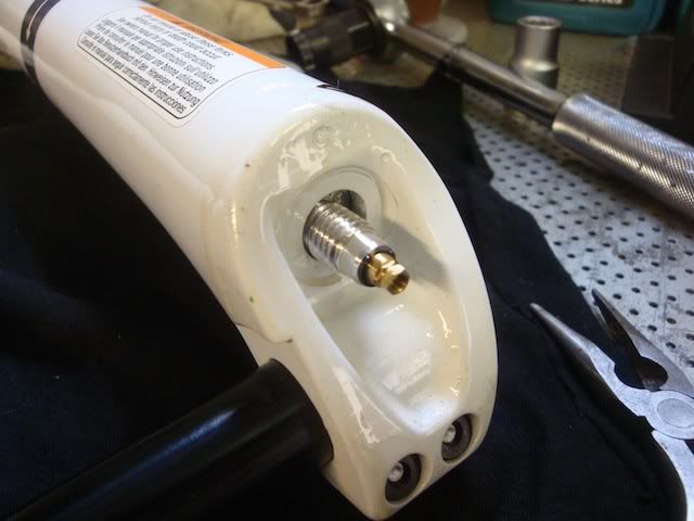

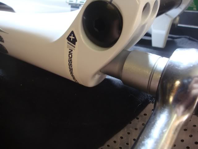

Using a 12mm socket, remove the footnut of the RC2 Cart
Step 4:

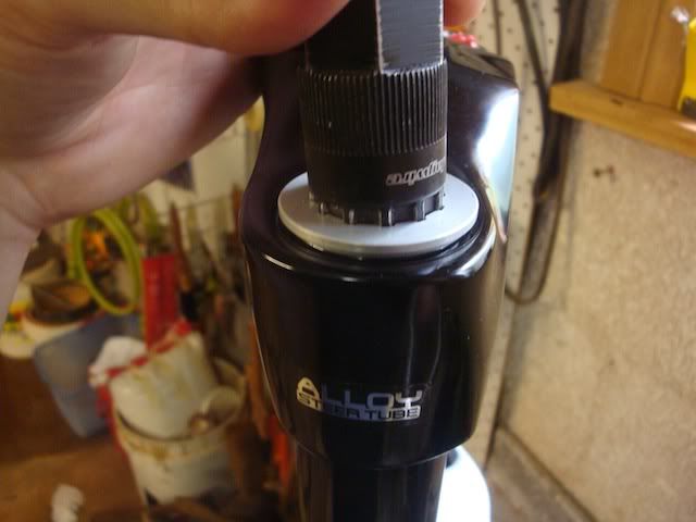

Using a cassette lockring tool, remove the top cap, be sure you have the fork over an oil pan because when you undo and lift out the top cap, the entire spring and cartridge assembly will lift out an oil will pour from the bottom of the fork
Step 5:

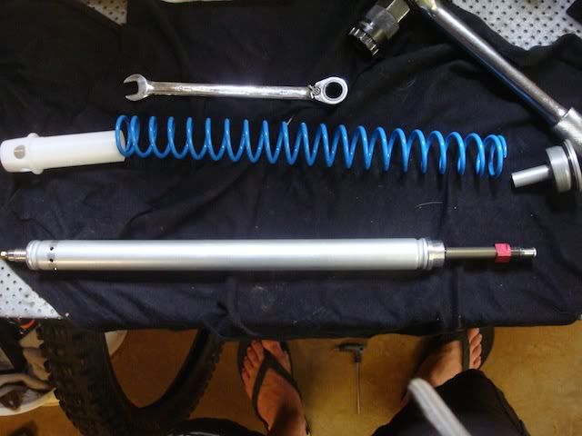

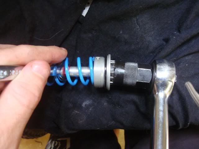

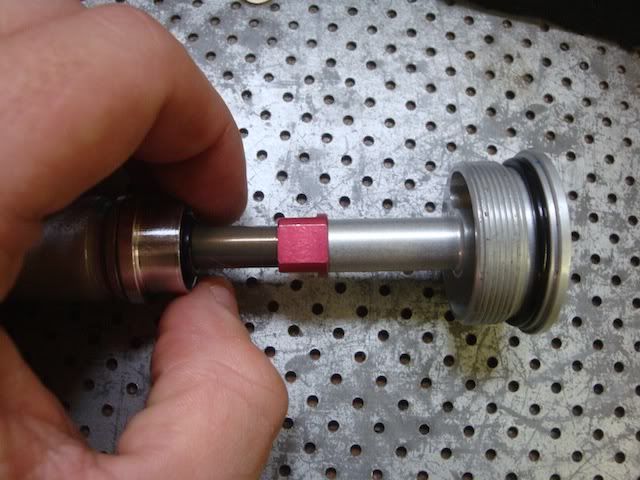

With cartridge removed, use a 10mm spanner to hold the red jam nut, and use a cassette lockring tool to undo the top cap, when its undone, remove the top cap, spring and spring retainer, set them aside in a safe place
Step 6:

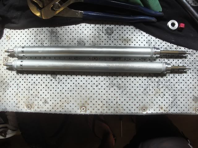

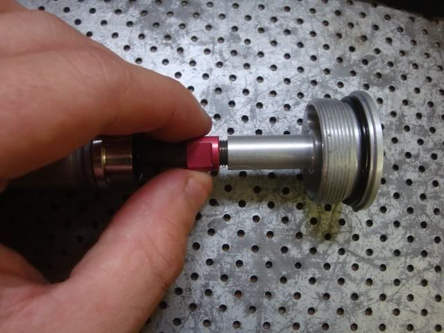

Remove the RC3 cart from is packaging and lay it next to the RC2 cart. Keen eyes will notice that the RC3 cart has a spacer on the base of the cart and is slightly longer than the RC2 Cart
A pic of the spacer on the RC3 cart, sitting next to the RC2 cart (3 on left, 2 on right)
The spacer can be removed by using a set of multigrips to grip it then unwind it from the base of the cart
The RC3 is slightly longer than the RC2
Step 7:
Because the RC3 cart is longer than the RC2 cart, should you want to install the spring onto the RC3 cart, you will need to cut the spring retainer at the black line shown in the pic. As i intended to run my fork as a single spring set up, I didnt cut mine
Step 8:

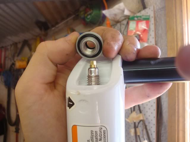

Reinstall the topcap onto the Cart, screw it on until it bottoms, then tighten the jam nut onto it. Also, if you are going to be running a spring, then install the spring retainer and spring onto the cart before you install the top cap
Step 9:

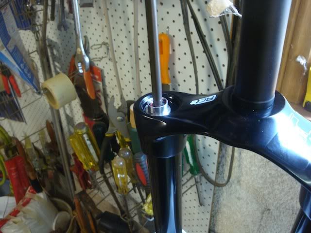

Using a 10mm Spanner and a 4mm socket, tighten the footnut by using the socket to hold the gold adjuster while you do up the footnut. Only use the socket until the nut has engaged the threads of the Cart and you can tighten the nut without the cart spinning inside the fork leg, cause if you break the gold adjuster, your screwed

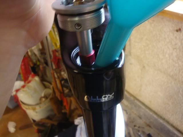

Reinstall the Compression adjuster, fill the fork back up with oil (consult Marz website for oil levels for you fork model), then using the lockring tool, reinstall the top cap and rebound adjust and thats it, your done!

hello. i got a used 44 on ebay and the compression damping barely seems to work and i have a few questions for anyone who can answer them:
1) that little rubber o-ring in the second photo under "Step 8"... what is it's purpose? i saw that on my cartridge and thought maybe it belonged inside the cartridge. i guess not
