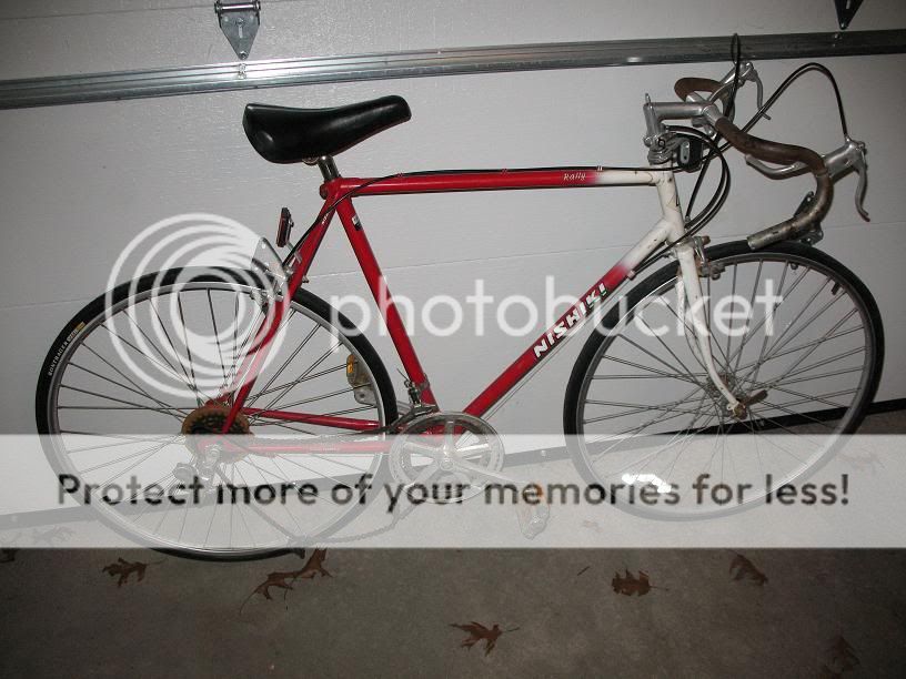

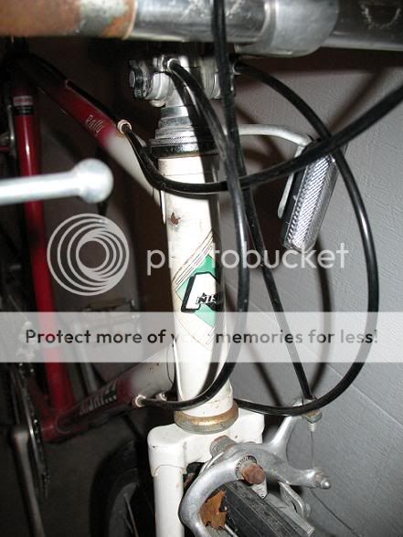

Before
It looks crazy I know but it will serve a specific and VERY important purpose soon enough. It has been built explicitly for one role and one role only and after my test run on the bike (I wasn't sure this thing would actually come together with all the hiccups along the way) it turns out it will work perfectly.
I just thought I'd share this stage of the process.

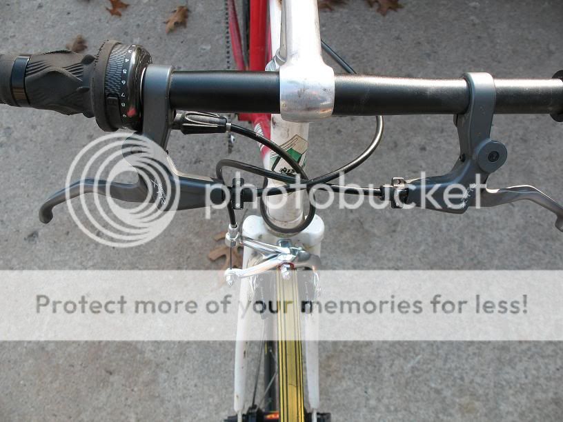

It's an old 80's 6sp steel Nishiki road frame/fork (graciously donated by a friend who knows its future role) I converted using old parts. It's moved to 9sp mtb drivetrain (rear XTR cassette / X.O shifter and derailleur) and Campy road crank/ring front. I threw on some old XTR levers to work with some side pull road callipers and finished it with an old Ksyrium Elite wheelset, odi lock-ons and an old flatbar I had kicking around.

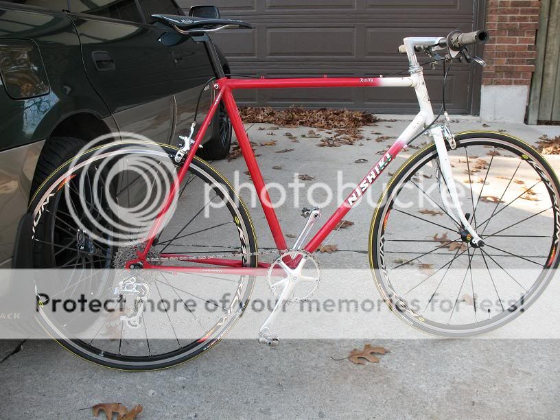

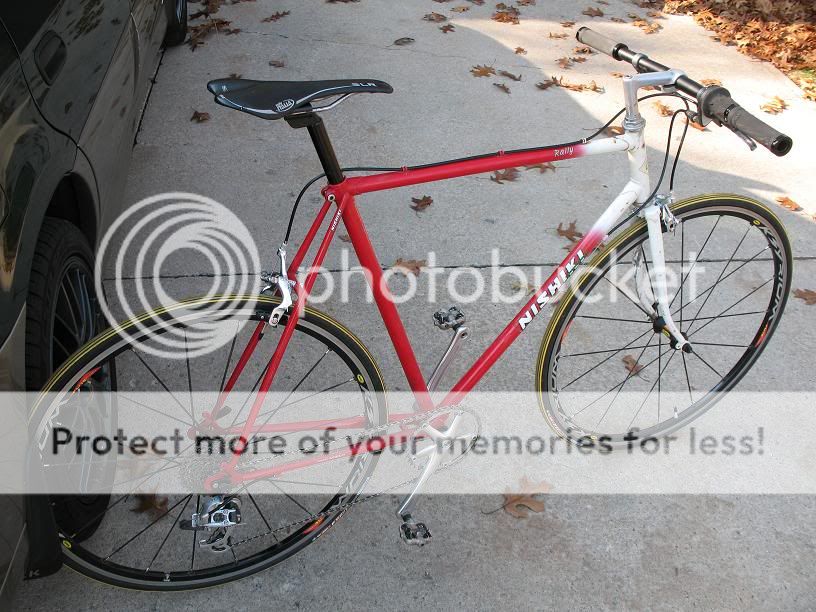

After
The bike is a bit twitchy (not overly so) but surprisingly comfy. Brakes are awesome and it actually shifts 100% perfectly. It's nice to ride! I was laughing the entire time.
This was a very quick mock-up and test run so now it's to be torn down and painted for its specific 2-day role. I hope it draws the attention I need when I get it done.

so how did you spread the rear triangle ? ( and Keep it aligned ? )
hahahaha.......... One of so many hiccups. I'm guessing you've experienced this too? :thumbsup:
Personally I took and old hub axle, put a couple of nuts on it and then rolled them outward. I repeated this until I was close and able to shove the wheel in. It's still not quite where I want it but I'll do more adjusting today or tomorrow. Bike is still perfectly aligned.
I had one beach of a time after getting the wheel on and then finding that the nut holding the rear hanger adaptor in place was rubbing the locking ring on the cassette.:madman: #$%^. it was one thing after another back there but it all worked out well in the end.

handlebars look scarry! I'd go wider..... but thats just me;)
?? It's not that bad.
24" (609mm) That's pretty wide really - I think.
Lol I guess that's wide for the late 90's my trail bike is running a 27" bar and the FR guys are running 30+ inchers now days but if you like it go for it!
I agree it's not wide by today's standards (these were extra bars tucked away in a box) but they're not too bad.
I was assuming you were thinking it was like the hipster bars you see on fixies nowadays. You know, those bars that look more like they're double-fisting a cigar or whatever. Now THOSE are narrow - no matter what their claimed purpose is.
Anyway, yeah, 609 isn't bad for what I need it for.
