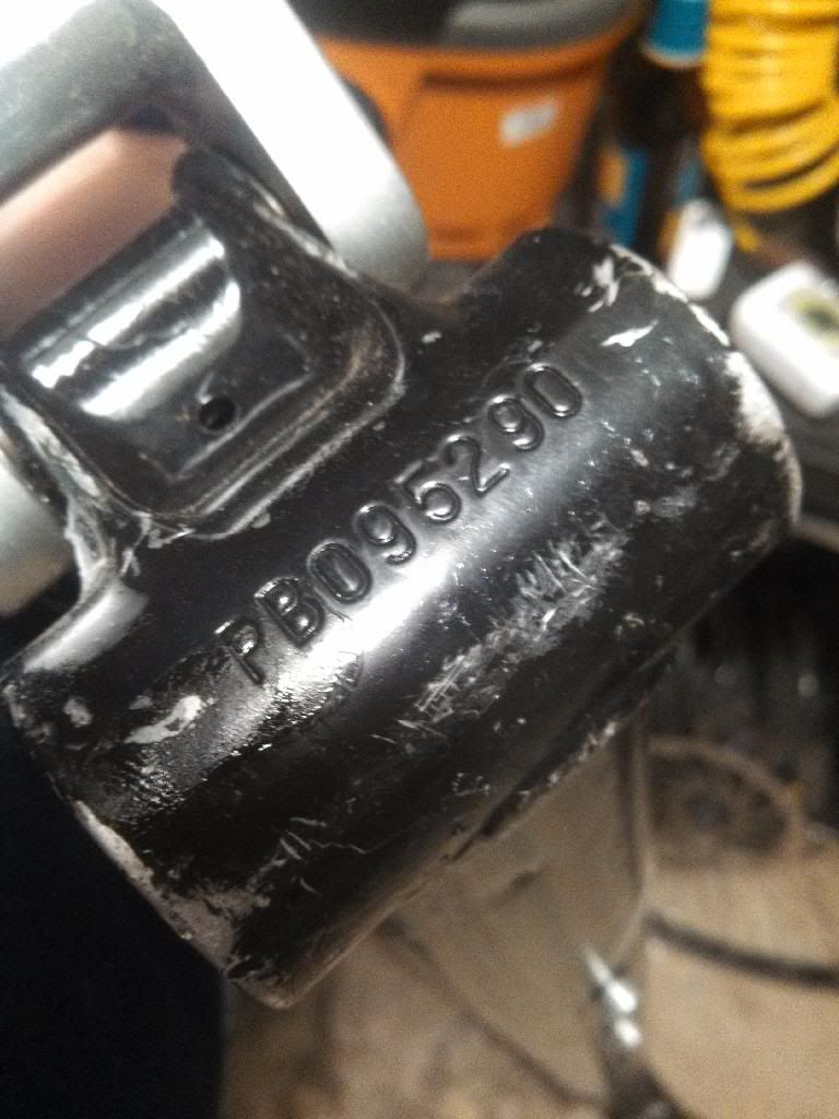

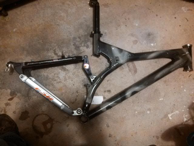

Picked up an old (Stumpjumper?) FSR frame that's had the front triangle repainted (poorly) for cheap. Trying to find some info on it to get the right parts (especially the rear shock and spacers) to build it up, without having to dig out the digital caliper (and also just to know what I've got here).
Looks to be circa 2000, and the rear triangle says Enduro FSR Fully Active 4-Bar Suspension. Serial number PB095290. Is there a standard way to decode this?
120 Posts
It looks like a 2000 Enduro FSR. If it has a disc brake mount on the seat-stay it's a 2001, but 2001s had silver seat stays too. I had a 2001 Enduro Expert FSR - a good bike for its time. Look it up on Bikepedia.com.

Thanks, that's why I couldn't find it - on Bikepedia it just says Enduro and Enduro Expert - doesn't mention FSR anywhere other than the Stumpjumpers. But that has the right adjustable lower rear shock mount.
Do you remember what size the shock is, and more importantly, what size the spacers are?
Also, is the flat spot above the bottom bracket on the "seat tube" supposed to be there? Maybe for clearance of the FD?
And I'm out.
506 Posts
If it is a 2000 Enduro, then my info reads that the shock that fits that is a 6.5"e-t-e with a travel of 1.5". Travel is adjustable from 3.8" to 4.6", lever ratio varies from 3.1:1 to 2.5:1. The width of the shock mount at the frame should be 1.2" and the one at the link should be 1.575"..... subtract the width of the eyelet (~1/2") and you can calculate the spacer / top-hat size you need.

So I built this up with some spare parts to verify the geometry and size felt good and they did. However I couldn't for the life of me get the shifting dialed in so upon closer inspection I found the seatstay bent. :( Luckily I caught it just in time to snag a replacement on Ebay. Slightly different bushings/bearings in the replacement so I swap'ed 'em out and was able to build the thing up. While I had it all torn down to fix the rear end, I repainted the front triangle. Here's a snap from her maiden voyage:
Got it prepared just in time for a group ride/demo day where I was able to compare against some more modern bikes (like a '14 Stumpjumper) and I honestly liked this one better. I was able to keep up with the folks demo'ing brand new Spesh, C'dale and SantaCruz rigs. Not too shabby for ~$100 and some spare parts. :thumbsup:

Looking at the top photo it looks like you already have the replacement swing arm. I had a '99 that cracked and that is what they replaced it with.
102 Posts
Discussion Starter · #11 ·
Ah, that must be why my chainstay says "FSR" while every other one I've seen says "Specialized". It does have the smaller hole through the cross member behind the main pivot bearing.
