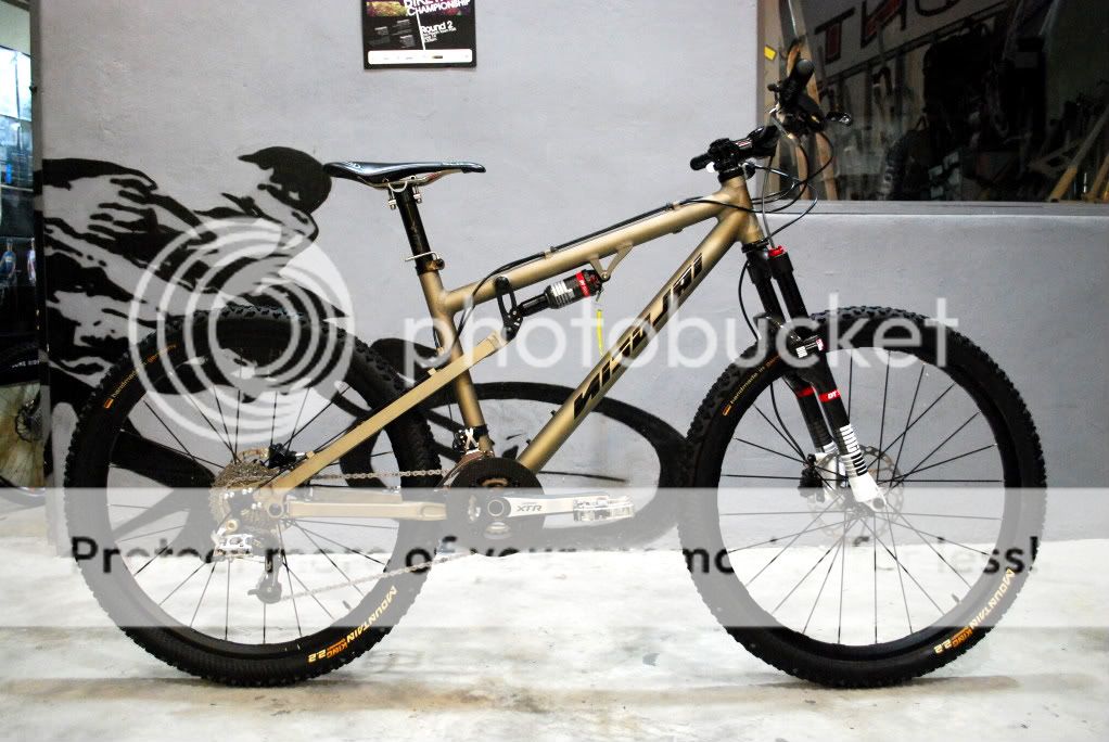

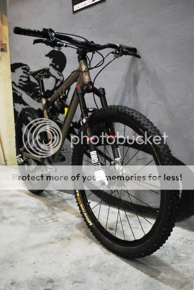

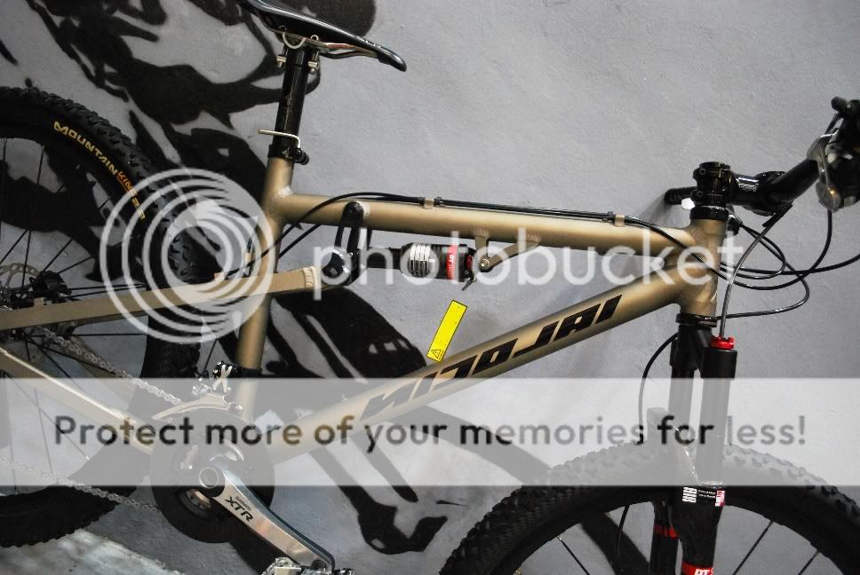

Hi guys, here's the Helius RC shown in the catalog with custom top tube cable mounts and superb welding! Finally managed to get this bike built up. Frame and rear shock is 2.393 kg and the complete build comes up to 10.8kg right now as it its! Will probably change to a shorter bar and soon the wheels will have to go too. Hopefully it will be able to hit low 10kg's....
* Frame: Helius RC
* Size: Based on a size S
* Color: Bronze Anodized + Custom Toptube Cable Mounts ( Frame as seen in catalog!)

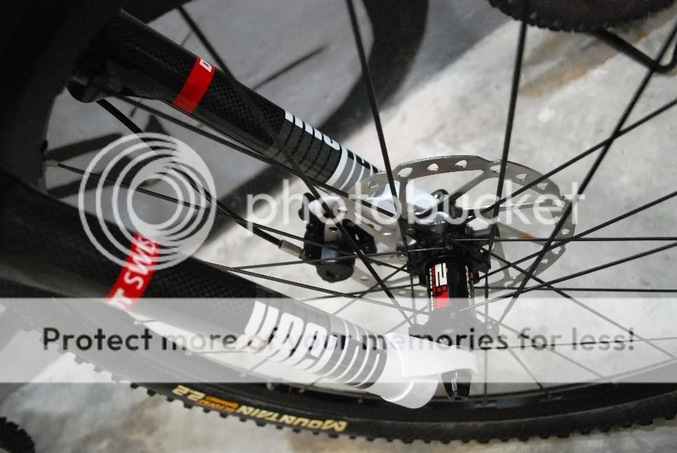

* Fork: DT swiss XRC 100

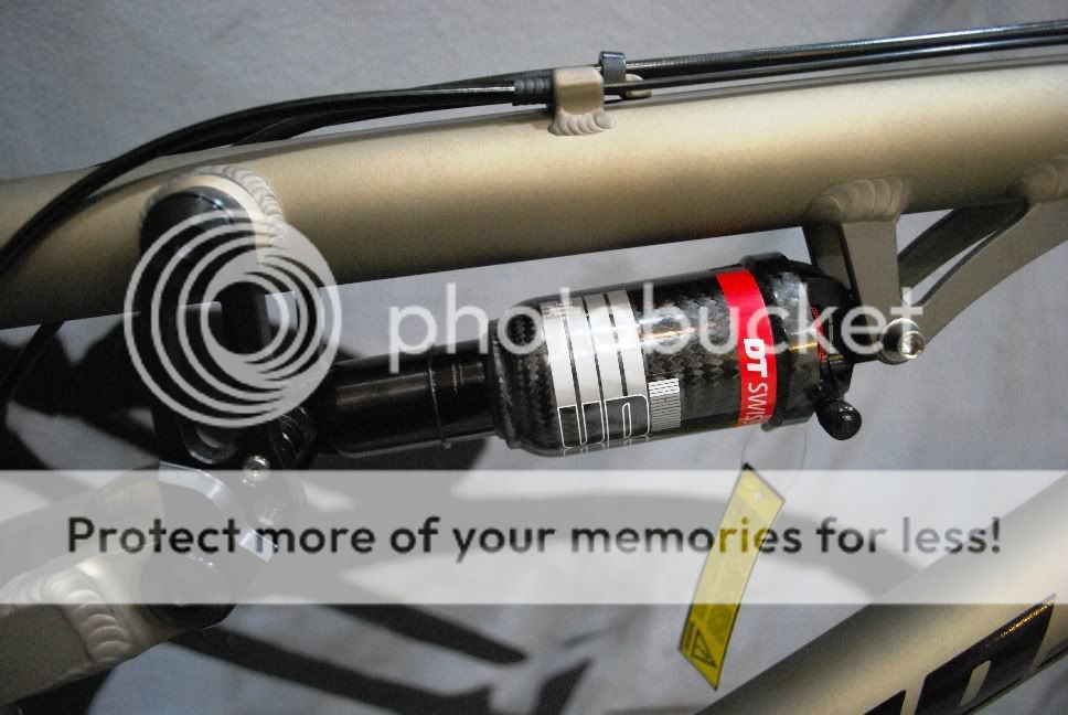

* Shock: DT XR Carbon eye to eye 165mm by 37mm
* Brakes: Magura Marta 08 Black + carbon Blade

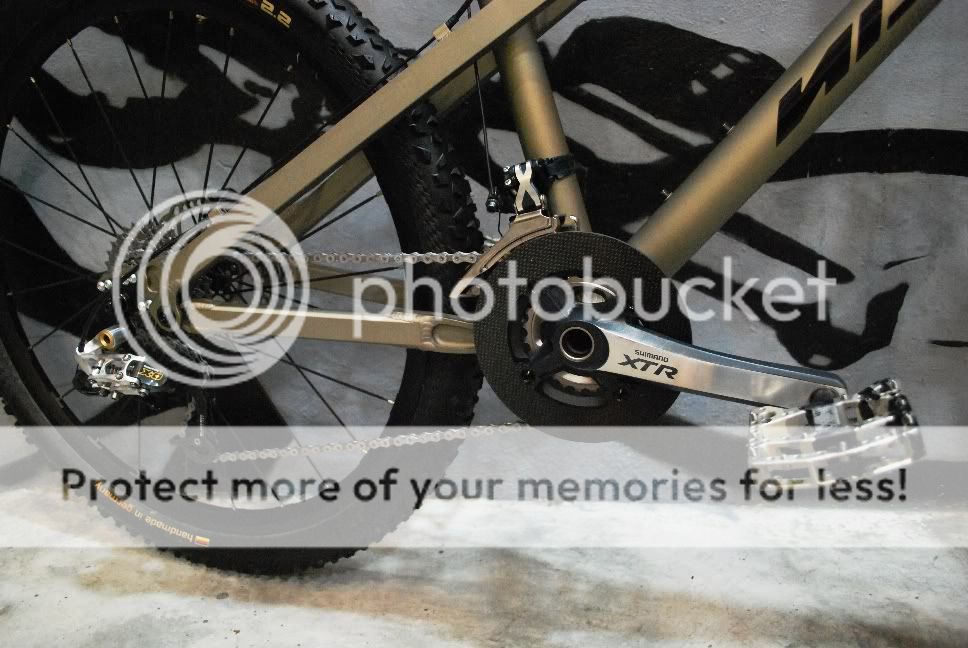

* Cranks: XTR 175mm + MRP Carbon Bashring
* Shifters: SRAM XO
* Front Derailleur: XTR
* Rear Derailleur: SRAM XO
* Pedals: Twenty6
* Stem: X4 Thompson

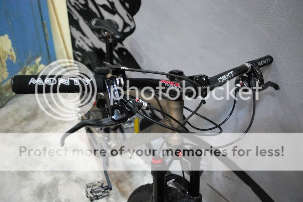

* Handlebar: Raceface 3/4 inch bar ( soon to change to something shorter)
* Seatpost: Tune
*Seatclamp" Tune
* Saddle: Selle Italia SLR
* Bottom Bracket: Shimano XTR
* Cassette: Shimano XTR
* Chain: Shimano XT
* Headset: GMP
* Grips: Monty Foam Grip
* Front Tire: Conti Mountain King 2.2 Black Chilli
* Front Rim/ Spokes: Tune Edelweisz WheelSet ( Update!!!)
* Front Hub/Skewer: Tune Edelweisz WheelSet ( Update!!!)
* Rear Tire: Conti Mountain King 2.2 Black Chilli
* Rear Rim: Tune Edelweisz WheelSet ( Update!!!)
* Rear Hub/Skewer: Tune Titanium
* Cables: Magura Standard
* Overall Weight: 10.8kg!! ( to be upodated after the wheelset!!!)

its on 2.2 tires now with not so wide rims, and the rear clearence from the frame is about less then 10mm each on both sides :? prety close. my guess 2.3 on narrow rims and 2.25 on slighly wider rims like DT 5.1 or something. But it doesnt make any sense to use that rim. haha
CHecked.. its 165mm by 37mm... :) sorry!
