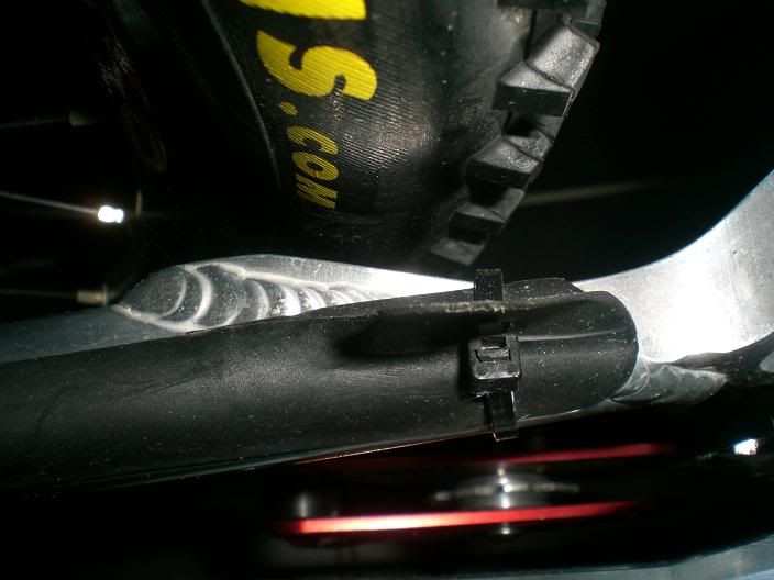

Here's a few pics of my recently built Lobo. Sourced an unused frame and it then took me months to source the parts. Labour of love for one of my dream bikes BITD. Yep I know they're prone to breaking and there's far better modern builds out there BUT building this has taken me back 10 years to when I had no wrinkles or grey hair :)
Here's the finished spec and a few pics
Frame: 1998 GT STS Lobo DH, Bonded Carbon fibre thermoplastic/aluminum

Although the frame was mint the existing decals had gone brittle with age and had started to flake. Had a new set reproduced which are pretty damn good copies, not perfect but good enough. The frame had to be 'tweeked' for the rear hose guides. The existing cable guides were given the Dremel treatement and a set of Hope Hose guides fitted. Got a few little jobs to do. Extend front Brake Hose, fit rear cabling, fit chain and setup chainguide.

2.3 is pretty much the max on the rear. Chainstays are very very tight.

Old frame, rear wont take a larger disc as it would simply eat into the rear stays. 203mm at the front cause I'd like it to stop!!
The rear shock is termed a 'pull shock', it actually pulls the rear linkage up when compressed. Basically another flawed design by todays standards but when these arrived on the scene BITD they were like OMFG I want one. Cost around $4K out of the box though and thats without race upgrades. Problem was the linkages were very prone to breaking and the bonding could sometimes come unstuck causing problems around the headtube.

The tyres (spelt with a Y as I'm a Brit) seem to be causing some concern. The rear is pretty mush already max'd out at 2.3, the chainstays are very tight on the rubber. It's simply not worth causing damage by risking a 2.5. I think the bike came originally with 2.2 Michelins. The front tyre does look a bit flimsy on the forks but with the Monster's I think anything would.
