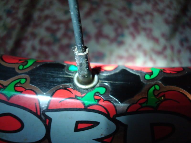

Here's my current rim, was measuring for fun last nite (2ft of snow in Arkansas means you're at home for a while).
I will be using on a fully rigid SS, because I want brickhouse strong for my large butt and some cush with larger tire pattern...
None of this suggets they're a "rip off"...
