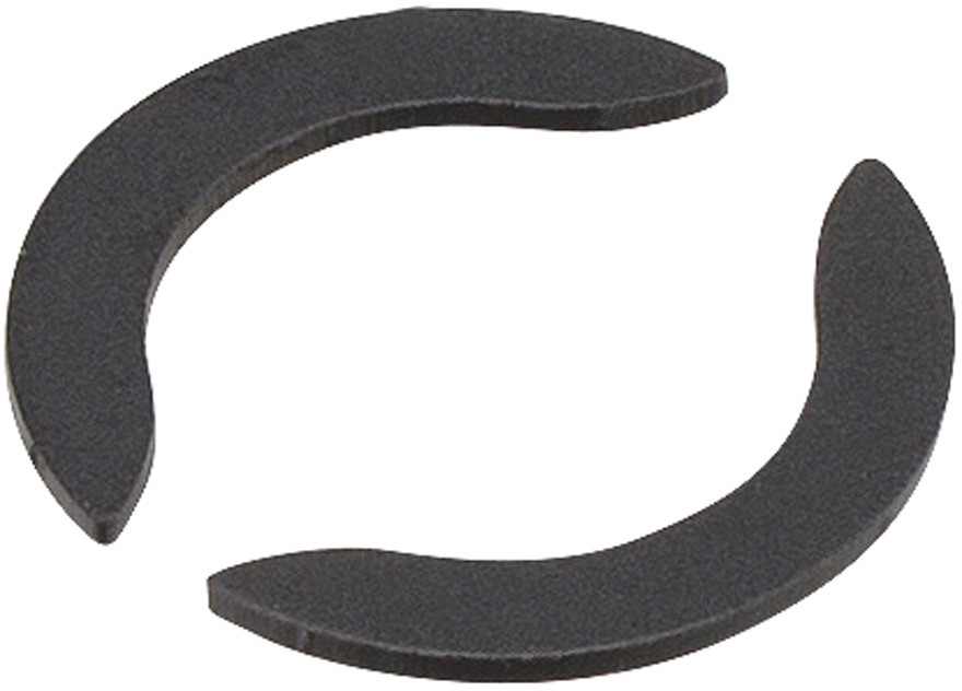

5,015 Posts
These make it easier to get the axle through the hub if you can't get torque caps for your wheel.
