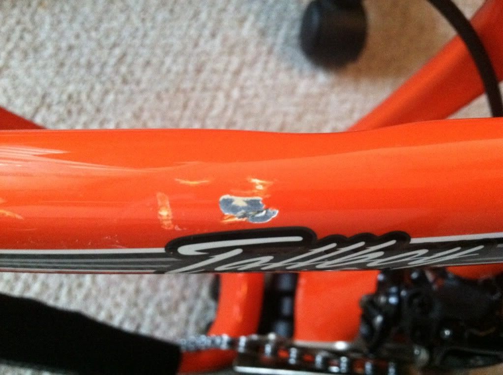

I want to get a rock guard, at least, for the underside. I've been searching around and haven't found much. I'm sure that they could make something that attaches at the lower water bottle mounts. After having this happen to my frame in a botched UPS delivery, I would like a bit of piece of mind
This would have done the same thing to a steel or aluminum bike

This place is where I ordered the 3M clear bra film to cover my BLTc. They included a piece of this stuff as sample. It's very abrasive resistant, but won't take an impact...as in all the impact forces will be transfered to the frame. If you look on SC's site, you can see SC stuck some double sided foam to the back of this stuff and is selling it as their downtube rock protection. It won't protect what you show in your pic, but will prevent minor rock debris from chipping paint.
