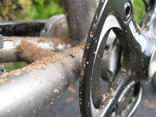

For the few of you who were interested... here she is. Might still do some upgrades in the handlebars and such once I get her out on the trail and feel out the specs. The FC EBB worked like a charm.
Nice!
I would replace the front shimano chain ring with a non-ramped version, the chain derails way too easily on the shimano ring. Oh, and maybe a rigid fork...(says the retro in me)
