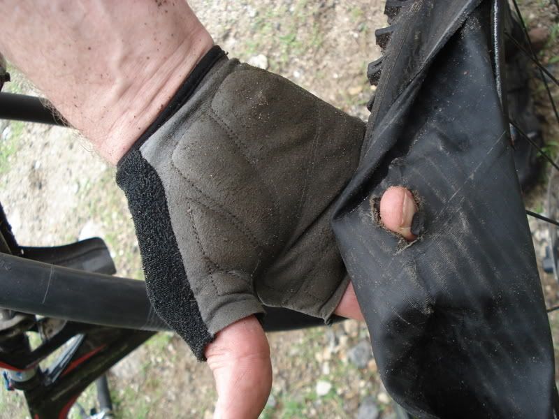

Slider got a 2" long slit in his rear tire right down the center of the tread - of course it happened when we were furthest from the car. We used every trick we knew - starting with the gel packet on the inside of the tire (lasted about 20 minutes), then tire patches on the inside:
This lasted for about 15 minutes.
Our third and final fix included tire patches, pieces of tubes and strips of tubes wrapped around the outside of tire. I wish I took a picture of that - quite the amalgamation of stuff I can tell you. That fix lasted about 30 seconds after getting up to pressure. It blew like a firecracker. Slider was walking after that fix. Luckily by then we had made enough progress to get him close to a parking lot, even if it wasn't the one we were parked at. On every subsequent fix the hole was longer and longer. Eventually the tire just completely lost integrity and was impossible to control.
Anyway, good ride and good to try out the McGuyver skills (even if it ultimately failed). I'll have to pack an extra tire for the next ride :D.

I've successfully used a gel packet/clif bar package to repair a sidewall tear. I've never seen a tread tear before this one - which is why we tried to repair this one so many times. When you tear a sidewall there's no pressure trying to rip it further, so a dollar bill or package works fine. When you tear the tread the tube is trying to rip the tire apart as you pump it up.

In the "old" days, I used a toe strap to hold a tire together like that. I still carry a toe strap, but it hasn't been used since.

I normally have zip ties in my pack, but didn't today, I took two off my bike and tried to put them together end to end over the hole. They were the cheapo kind of zipties and couldn't hold the pressure. Toe straps would have been good.
