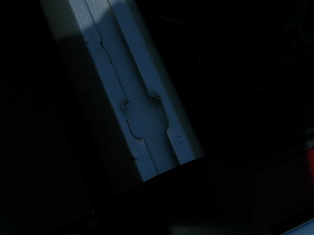

I HAD one on my '09 VW Tiguan until it broke a month later and my bike almost ended up falling on my panoramic sunroof:
The bike carrier tore right through the metal on the cross bars. I think this was just an isolated incident though, since Thule makes all VW's racks. I ended up getting my money back from the dealer no questions asked and replaced it with a Thule 450 Crossroad. I'm much happier with it. The OEM one looked much nicer IMO, but the Thule is more versatile.
