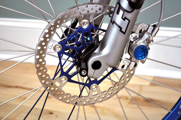

i bought a set of hope tech m4 brakes.the rotors that came with the brakes are 203mm.does any of you ells owner experience any problems?like a broken rear triangle perhaps?i use a talas 36 rc2 in froNt with the 203mm rotors.hoping to hear from you guys,thanks

I have a moment with Hope tech V2's with standard 203' rotors, a rogue with Hope tech v2's with 203' vented floating rotors and an id with Hope m4's 180 floating rotors.
I originally ran a vented rotor on my moment but it vibrated sending a vibration through the frame so I swapped it for a standard non vented non floating rotor.
No problems with the frames at all

I use 203 Hope Floating Rotors front and rear on my Moment. No issues other than fantastic braking.
Doesn't matter what you think of the power, no warranty on a Moment with an 8" rear disc.

Why run an 8" rear anyways? Most of your stopping power comes from the front brake. 8" is overkill and will void your warranty. World cup DH riders use 6" rear discs. Nuff said

I use hope Mono M4s, a 203 front rotor and 165 rear (on a decently built RFX with custom coil shock/marz 66). Plenty of power on both ends. Can lock em when I want, but I definitely wouldn't want a bigger rotor in the rear, I'd have less modulation and more weight for no good reason.

kmac999-the 203's came with the brake set already.here in the philipines we dont get the luxury to order what rotor goes with the brake set when you buy it at the LBS.Rotors here are expensive!thanks very much for your input,i appreciate it.i need to downgrade the rotor plus a new adapter.again,thanks
