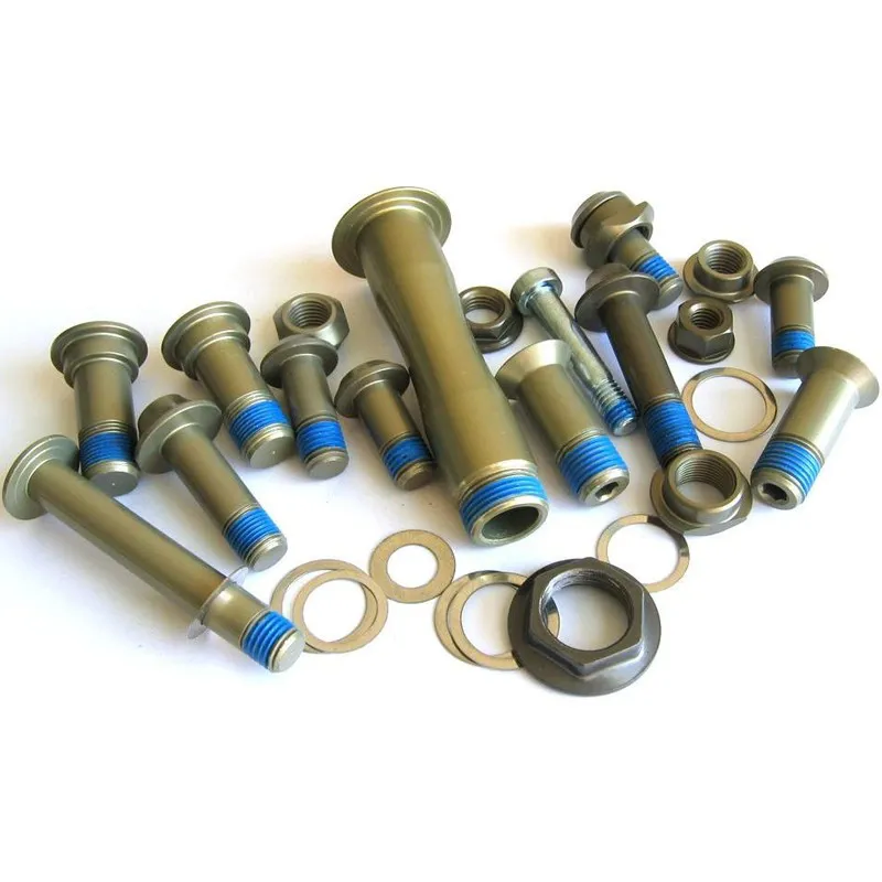

I have really enjoyed my new-to-me 2010 S-Works Epic 29er. I have upgraded the hell out of it with great stuff!
Now I'm in big trouble. I was shredding as usual when I noticed my rear wheel flopping around badly, especially rubbing the right chain stay. I thought I broke a spoke, but no such luck. I lost a bolt. This turns out to be a precious proprietary bolt that no one sells anymore. I'll circle what I need:
Household hardware Art Cylinder Auto part Gas
In the good old days, you could buy the kit:
Without this magic bolt, my frame is totaled. Help!

Give your local Specialized regional office a call. They may be able to help.
Sent from my Pixel 4a using Tapatalk
find a local machinist and bring the other bolt,
a new one can be cheffed up on a lathe in minute$$$

Oh, this is brilliant! I need to find this local machinist person but am going to try.

Regional as in North American, European, UK etc sales or technical office. Taking the bolts to a machinist to replicate is a great idea

Yes, and if anyone reading this happens to be a machinist with my bike and a PayPal account, let's do business ha ha!
watch cutting edge engineering, or abom79 youtube channels....
machinists can fix and make anything
Not as simple as it sounds as it needs to be a case hardened bolt or it is going to break again. I would try to order two of these from Specialized so as to have a spare one in the future. In some ways it is a manufacturing defect as the engineers under specified the bolt in terms of the material or case hardening.

Depressing but fair. However, I believe the bolt worked its way out rather than broke...hard to prove, but my mechanic said this was a common problem in these bikes.
That's for the 2011-2013 Epics. My LBS said 2010 is different.
any machine shop who makes parts will have small diameter rod stock of the hardest materials...it's not about 'making a proper bolt' it's about finding someone who has time to slot you in, get it done, and not break your wallet.
at any rate, someone has to have this part in stock and can sell it to you
failing that and if you want to keep the bike, buy one used, or make the bolt up custom
I do some hobby machining. I don't have the tools & materials for that bolt (it definitely needs to be hardened) but any reasonably competent professional machinist should be able to make it easily on his lunch break. Go talk to your local auto mechanic -- preferably one that restores vehicles but that's not required -- and they'll know where you can find a machinist who could make this.
Others have indicated the bolt must be case hardened. What is it about the picture that makes one assume the bolts are hardened. I am not saying they are or are not, I really do not know. The bike and rider are fairly light compared to most applications. Due to weight concerns, I would think the material is light weight alloys. Since we are talking about one bolt, steel could be used. I would think a person with a lathe would take an existing button head bolt and turn it down. The challenge will be finding the person who will spend the time turning a new bolt. That bolt may cost hundreds.

Seems like you guys are overthinking this (by miles).
Can you post a picture of the location of this bolt on the frame?
It's tough for me to believe this is something that's impossible to deal with using standard hardware for a few dollars.
It's a shoulder bolt FFS.
You should be able to simply measure it and order a few here:
there is no 'must be' anything with this bolt
case hardened might be spec, but induction hardened will work 110% fine.
ffs....if you can't source an OEM just have one made up...simple and gets you rolling
The link I posted has tons of grade 8 as well as some 12.9.
Shouldn't need to have anything made.
Everyone repeat after me:
"It's just a frigging bolt."
"It's just a frigging bolt"? NOPE. It is custom made. I had the same issue with a bolt for a Cannondale Scalpel. Spent a lot of time looking at web sites for a replacement. If the measurements are not exact, the bolt will move around in the frame and the bearing.

I don't know about this bolt per se, but the pivot bolts on my Giant are aluminum (not nearly as strong as something mentioned above). And yes, a good machinist is good at measuring.
