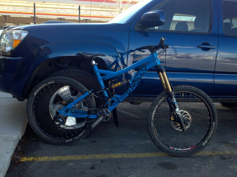

Here is my current cable routing, and I am not sure if I will change it up.
Initially, I had run it down the seat tube, thru the linkage and then up the cable stops for the front der. I didn't like where/how the cable slacked and ended up sticking out from the frame. I also didn't want to get it pinched in the linkage somehow, but it all looked clear.
Now, with this routing (shorter hose), I just run it through the RS Reverb guide tied to the seat tube and it has a long unsecured loop that goes up to the top cable guide, then to the remote (mounted upside-down on the left side, one of the benefits of the 1x9 setup - VERY clean and ergonomically friendly).
With this routing, you can see where the cable accumulates when the seatpost is slammed. When it is extended, it more closely follows the top contour of the shock. It doesn't bow out towards my legs and I don't see it being a real problem of snagging trees or anything. I'll be watching the cable for any signs of wear that have to do with it touching the linkage on the outside, as I anticipate it might be in contact too much over the course of time.
I really don't want cable slack accumulating out back of the seat tube where the wheel will catch it - I've seen that happen with several different setups and looks like a quick way to end up with a hose worn out/ripped out mid-ride.

Thanks man, and thanks for the initial guidance!
Play with the routing on yours and see if you can come up with something...I'd try a different setup (have considered zip-ties to the TT, but that leaves the coil of cable off the back) if I could find one that worked with less unsecured routing.

Well it is on the underside of the left side, I am running 1x10, and the cable isn't long enough to do as your diagram suggests. We tried a ton of things and this is the best so far.

Yeah, I don't think my original cable reached down that far, and I didn't like the way the slack accumulated so low - seemed to be a liability for snagging on something.

I run the CC Angleset in the - 1.5* setting, 180mm fork, and the Large Delirium in the slackest setting. The BB height is 13-3/4". The routing of the Reverb seat post remote cable is run down the seat tube with the provided cable guide at the bottom of the seat tube. I don't use the bottom Delirium Cable Guide, just the other two. There is slack in the line when the seat is in the "down" position. The line is taught when in the "up" position. Hope this helps answer a few questions. :cool:

So mine is like Dom's now, with only a little more slack in the line than he has. I managed this by using a hair-thing (rubber bandish scrunchy thing? like a cloth-coated rubber band) that is on the BB on the non-drive side, hooked to one of the reverb cable-joiners to pull the slack where I want it. Hope the pics explain better than I do - I needed the elasticity of the rubber band without the friction that would keep it from retracting while in contact with the frame.

It works to keep the cable loop from bowing to the side and coming into the crank arms/etc.
Definitlely didn't work as well until I used two guides on the seat tube to guide it down, luckily I have a plethora of SRAM bits, as this is my third Reverb.
