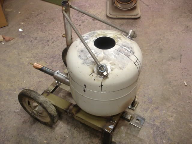

No, it actually took two hours. Casting aluminum is easy, all you have to do is cut the shape you want out of Styrofoam, I made a hot wire cutter for the Styrofoam, then bury it in sand and pour molten aluminum into it. The aluminum melts the Styrofoam and takes it's place in the sand. After that you just pull the casting out of the sand and clean it up.

How do you melt the aluminum?
I built a foundry out of an old propane tank, I cut it in half and lined it with a home made refractory made out of clay, sand and Styrofoam balls, the Styrofoam balls melt the first time it is fired and leaves thousands of little air pockets to help insulated the tank. It is fired with propane and gets up to 1800 F. It will melt a quart of aluminum in about 10 minutes. It is really fun, I have made a ton of stuff I would have otherwise had to buy and also things that simply don't exist. Here is a pic of my foundry.
I still havent painted it, probably never will but it works perfect. The burner is the tube sticking out the rear, the lid lifts and swivels with the foot lever sticking out the front. These pics were taken before I added the handle.
Don't want to rain on a parade, you did a nice job. For $80 I would have just bought them off the market...being a machinist / tool&die maker for a number of years I know what it takes to make castings from scratch.
From what I see you have over a dozen holes to drill of varying diameters, over half of which need to be tapped, foam shapes to make accurately and bury and pack in the sand with sprues...lets not forget firing up the crucible to melt the 3/4 pounds of aluminum and then pouring, breaking them out of the sand/quenching and then cutting/cleaning up the sprues on a belt sander before the bead blast to get the finish in your pics. I won't mention the pin imbedded in your first design that was located in your foam form, so obviously there was two iterations of the same concept.
