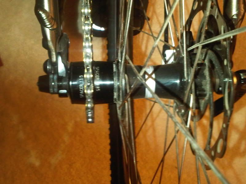

As for the rear hub, I think I can fit a 9-speed cassette on there. The most telling photo I can take is the one showing the hub spacers (as shown from the bottom, with the bike in the missionary position):

Yea it's different when you have 9 to choose from and not 1. :p I saw the pictures of the rear hub and you shouldn't have to replace it. Its just got a spacer so you should be good to go with your parts. The SRAM 11-34 goes from 11t, 13t, 15t, 17t, 20t, 23t, 26t, 30t, and 34t so your SS be a little over the middle of the Cassette. If you don't like the gearing then just throw on a 34 or 36 tooth chainring. But it is your bike so do as you like. I do want to see some finished pictures though.. and they better be quick! Oh and the only tool you may need is a cassette removal tool, you don't really need a chain whip, as wrapping a towel around the cassette works just as well.
