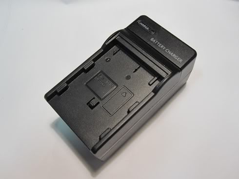

I had a few people ask me about the charger for the camera battery, I've just done another one so thought I would include some photos along the way.
Cheap charger which can be had for a about £5-10 from various online shops including ebay.
Pull the top part down to separate the charger and battery interface.
Open up to reveal the connections.
Drill the bottom of the outer shell and solder on connections to the charger.
Secure everything in place with the glue gun
Reassemble.
