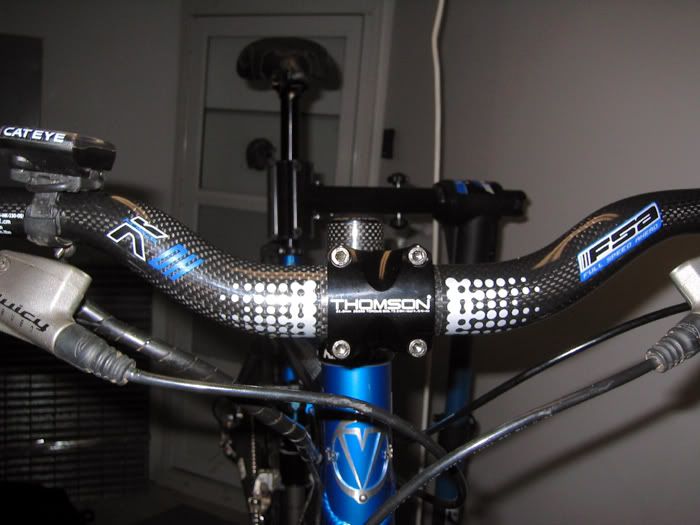

My Salty has found the lord. Lord of the All-Mountain that is!!
I made some changes to seperate it from my XC Burner and hopefully realize it's true AM/Trail capabilities. This bike loves it nasty.
Changes include;
New front triangle (including shorter HT, new HT badge, new main pivot, new cable routing), Fox Vanilla RLC 130mm fork, 185mm rotor, FSA K-Force DH HB, Thomson X-4 stem, 2x9 drivetrain with RF bashguard.
The HT badge is absolutely stunning, no pics that I've seen do it justice. The new cable routing makes for an extremely clean install.
Teresa & Sherwood continually set the standard in customer service/support. They have once again made me proud to be a Ventana owner.
D.
Oh yeah, I know my camera sucks!

The pics really don't do it justice
mudpie said:
good job your bike looks great, are you going to break it in at Bull on Sat ?
Thanks. I would be remiss if I didn't acknowledge your influence in my new bits for the re-build. Not to mention that's your old fork. Riding with you made me realize I was selling the Salty short.
I think I'll hold off on Bull Mtn. until I get totally comfortable with the changes. My knee is still scraped up from the last visit.
paddlefoot, 28.74 lbs. on a Feedback Ultimate digital scale. I knocked a 1/4 lb. off and beefed it up!
D.

Follow-up, clarification
I took the Salty on a short shakedown ride with LoneStar this a.m. (37*F and raining)!!!
A few observations:
The handling seems to be much improved with the combo of the shorter HT and 28" bar. I didn't feel the front end wanting to loft on climbs like before.
Ciclistagonzo: I run the front backwards and the rear the recommended direction. I find the front to track better with this configuration.
RedRocker: Don't worry it'll be there.
steiny: 5" of course :eek:
TIGMAN: Thanks, great minds think alike :p
kev: The measured #'s are: 69.5* HT, 70.5* ST, 13.625" BB.
I like the shorter wheelbase for the tight Southeast trails and the traditional double-diamond shape of the Salty. I'm pretty sure there has been a Salty with 6" rockers posted here, I just don't remember who. A call to Sherwood would definitely answer those questions.
I hope to hit Chicopee tomorrow a.m for a better test.
D.
