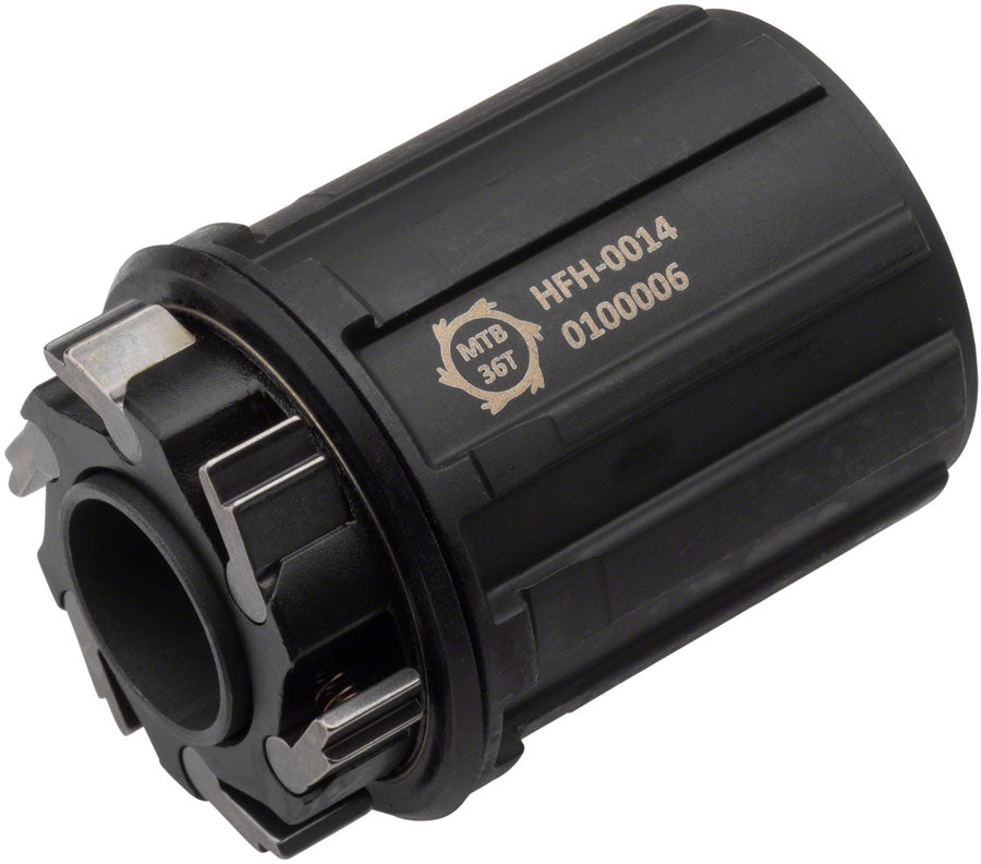

Hey @BujiBiker, I am a crazy person and I spent way too much time trying to find a place to buy Bear Pawls hub parts. So, I found a U.S. contact person it and you can order parts to increase engagement or convert to ratcheting style freehub. And it's actually pretty cheap and easy to increase engagement! I don't want to post the info here because I found it through the notes of some distributor rep. But if you need to know more you can PM me.

Oh yea. I just replaced the freehub and it was very easy to do. I upgraded from 36 points of engagement to 72 with a 6-pawl freehub for $70 shipped. If you are interested I can PM my contact to get the freehub.

I paid $70 for the 6 pawl hub. mtbnut1967, I think the teeth stay 36 but the number of pawls increase to 6 to double engagement. Bear Pawls has a 72T hub, but you gotta upgrade the whole hub, I think.
Here's a quick writeup on how to do this upgrade, since several have asked: Remove the wheel and then the cassette. Remove the endcaps with needlenose pliers (use something soft to protect the caps) and the freehub and carefully wrap those pawls with a rubber band to keep the springs from falling out. Be careful to note the orientation of the spacers on the hub and freehub. (if you find your hub engages poorly after, you missed this step). Clean all that stuff out with WD-40 or similar. Be careful you don't use something too crazy because it's bad for the sealed bearings. Lightly oil (Evan says TriFlow but I used wet chain lube) the hub teeth and new pawls on the freehub and also wrap that dude with a rubber band. Once you got that freehub on its way to seated you can remove the rubber bands and gently turn the freehub until all the pawls go click click click.

I'm now running a steel, 3 bearing, simultaneously engaging, coil sprung, 6 pawl e-bike freehub body, received through Evan. This thing could kill a tank, if it was going fast enough. All the "leaf" springs on my prior two bear pawl freehubs were failing, and the aluminum freehub body was deforming in significant ways at the pawl pockets. I killed 2 in less than a year.
All the popping and pinging went away with the new steel ebike rated hub. I cannot, however, speak to degrees of engagement. No idea, don't care, just want a bomber hub setup. I think I've got it now.

Sorry for the late update but I was able to get the 6 pawl hub from Evan and the install was pretty straight forward. Thanks for the tip on using the rubber band around the pawls because that made the process so much easier. Tried it without on my first attempt and could not get hub to engage properly. Also, make sure you install the spacer on the hub first.
So far I love the improved engagement and low cost makes this a no-brainer. Glad I found this thread.

When I got my 2019 Cascade Peak I noticed right away that the freehub bearings were very tight. After some back and forth with Fezzari, they sent me a replacement which was a little better but still did not spin freely.
I decided to ride with the replacement unit anyway, but the bearings have failed after a little more than a year of moderate use (I have multiple bikes to ride). It is clear to me that Bear Pawls is not assembling these freehubs with the correct length of internal spacer, which puts a ton of load on the outboard bearing when the axle is tightened.

I did not try contacting Evan, but Fezzari sold me a new free hub for $35. When that one breaks I am getting a new wheelset.
