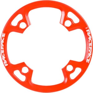

After this weekend and noticing that my big ring is already badly damaged after less than a half dozen rides on the new bike I've been encourage to get a bash guard.
This popped up on Chainlove a while ago for $15. I've got a Pitch with a 22/32/44 setup and I only had about 20 seconds to make a purchase so I got the red one in 34t size. It's made of aluminum but I think some of the trend is towards the plastic versions.
Is this 34t gonna work or should I look for something else? Is the "Bolt Circle Diameter" of 104mm the proper size/dimension for my Pitch? I would assume that most nuts & bolts are somewhat standardized but in my 40-some-odd-years I've learned to never take something so simple for granted.
Ted at DNA Cycles said the only think I'd need for installing a bash guard (besides the guard) would be longer bolts since this guard is thicker than the cog is. Would those bolts come with this guard?

That'll work. I have the same one except for 36T and black. Works great and is very light and durable.
837 Posts
usually when you go to a basher you remove the large chain ring. that allows the original bolts to still work. the extra clearance is so nice for rock hopping.
655 Posts
bigO, same guard that I run, didn't need longer bolts, the 104 is just what you need, the aluminum is very durable. Mine were $45 a pop, nice deal that you got.
1,342 Posts
If in the future you want to change color, you can't go wrong with BBG bashguards for $18 shipped.

Great news! I assumed that 34t had the outer diameter of a 34t cog which would be slightly larger than the 32t ring I have on the middle and quite a bit smaller than the 44t large ring so I should have some extra clearance. No I'll need to work on my pedal stroke to avoid the pedal strikes...

I put a bashguard on after slicing 4 could size chunks of meat out of my calf from slipping and being attacked by my big ring.

Mike, I think I have the exact same bike (Pitch Pro 2010 in brown) as you, save for the paint. I bought the exact (well, green not red) same bash guard from Chainlove about 3 weeks back. I took mine for it's first ride with the guard and ground some paint off of it on Waterfall on Saturday.
I received the green bash guard in 3 days from Chainlove even though I had paid for the slow boat 2 week service. Excellent delivery and service from them so far.
I slipped my big ring off and the bash guard on and used the same bolts that came with the bike with no issues. You will be fine with the setup you purchsed.
Was probably the easiest upgrade to a bike I have ever attempted. 4 bolts and the ring slips over the pedal and off followed in reverse by the bash guard.
Mike, a 34t bash is made to cover a 34t ring, and so on. If you ever decide to move to a 34t middle ring you're good to go with that bash.
Check out the Blackspire Stinger chain tensioner, it makes a pretty solid 2 ring set up when paired with your bash... for little money.
