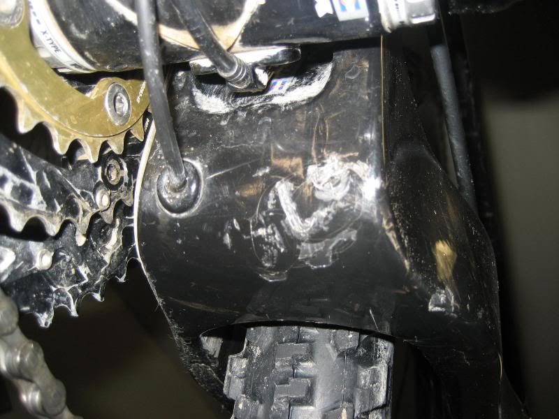

I suggest putting a thick piece of 3M tape on the yolk that hangs below the bottom bracket. It's a rock magnet and the CF bruises easily. This should have a metal piece for protection like the right chainstay has.
Very valid point. Here is mine and it has heli-tape on it. I added electrical tape on top of that now.
