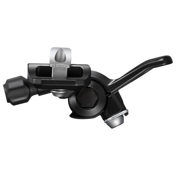

Hey, I was thinking of going the shimano dropper for the same reason you did to clean it all up. Did you research between the 2 they offer between the 500 and the 800 series. I cannot really tell much of a difference except price.
Was it an easy install, did you have to pull the whole unit and change out the outer cable guide too. I will be changing out my brakes for the SLX ones too so probably easier to do it at the same time.
Very little difference between the Shimano MT500-IL and MT800-IL. Make sure that you purchase the IL version, as that's the one for ISPEC EV mounting. After watching the comparison below, I went with the MT500. The dropper cable is the most challenging of the cable routing. I reused the stock housing and ran my new cable through it.
this is good video to show you the difference between the 800 and 500. I personally have the 800 and it is fantastic. No wobbling. Positive feel. love it
