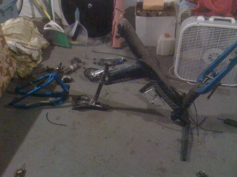

Sorry about the low quality pictures, will get some legit ones once the front end starts coming together.
Stripping it down, still dirty from last year
Will keep this updated as it progresses.

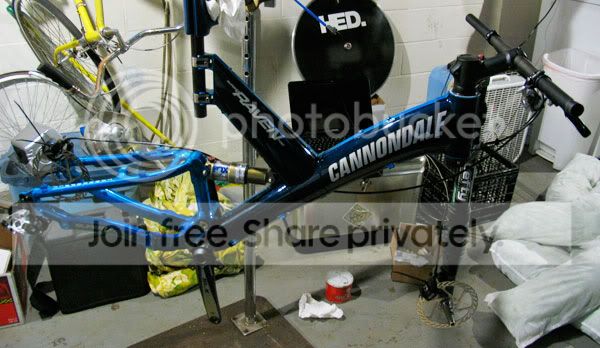

Put a few hours in today. Finished cleaning the frame and swing arm and gave them both a coat of wax then it was assembly time. Got most of everything on and at least in place. Still need to sort out routing the lines for brakes and pick up some cable sleeve for the rear derail. Big surprise today was a much needed upgrade in the crank and bb area with a set of shimano xtr m970. Going to get a bash ring and straight cut middle gear for it and it will be all set. The old square tapered bottom bracket weighs almost as much as this crank set so needless to say, I was quite impressed! May also grab a new set of bars and a few other key items yet to pick up but none the less, progress.
Will be a sweet bike once finished.
