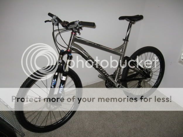

Tricks?
In 4"-not-too-expensive-land, I can think of these...
BlurXC - Just plan on a bit of maintenance
Turner Flux - Heard nothing but good things...never been on one tho.
RacerX alloy - Great bike, but not as good as the Yeti for some wierd reason despite the fabled Horst link.
Orbea Oiz Alloy - amazing bike with wonderful suspension, but the chain stays stick out too far for pronated me
Els Truth - is a great endurance/trail bike but awfully expensive for an alloy 4"er.
Devinci Moonracer - Recent thread on it here...I had never heard of the thing Price?
Alloy Scalpel with std fork so you can use your wheels?
Trek fuel - The new suspensions look pretty sweet. I didn't like the old ones at all.
GT - They are trying to be hip and cool again...might be a bargain..suspension look wierd
Fisher HI-Fi - a bit too much travel for me, but raceable
Felt - More travel, heavier, but looks pretty cool.
