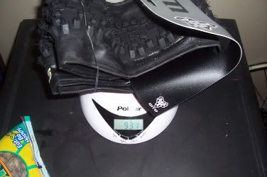

my WTB Stout 2.3 came in right at 900 grams (minus the packaging)
Photobucket
