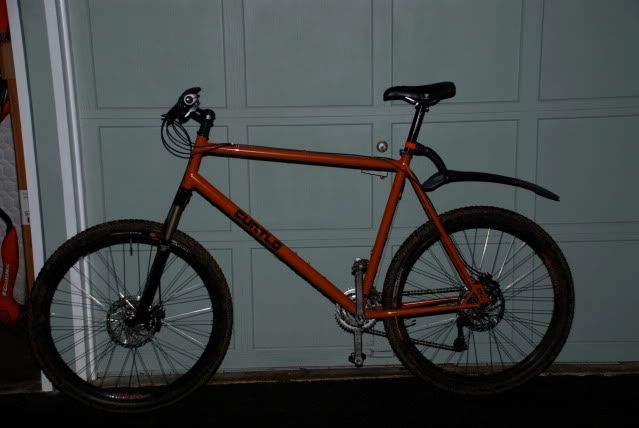

Hello All,
I have dilema, I purchased a custom frame from a reputable builder. The problem is I am very tall and this was my first shot at a frame that fits. I will say it is close but I have a big problem. My hands start too kill me after about 45 minutes and they are done after an hour and a half. The frame is amazing and my experience went well but the bottom line is I think TT is too long. I don't blame the builder since he did the best he could without any reference to compare it too. And technically I sit on the bike and it fits close to how it should after reading multiple fit guides. My next one will be shorter some day, but for now this is what I have. I felt very stretched out the first time I rode the bike but thought it was because I had never really ridden a bike that fit. After a few rides I shortened the stem from 130mm to 100mm and it seemed to help. But still the aching hands. So I put Ergon grips on and it helped a little but still the pain. I now am considering a 70mm to 80mm stem with a 2 inch riser bar. At the moment I am running a 1 inch rise. My question is has any one run into this hand issue and will the new stem and bar setup mess up my handling. It is a XC bike and the stem is getting pretty short.

Pics
Here are a couple pics, Me on the bike and the bike itself. And yes it is a 29er :D.
The bike in the picture on your blog has the bars lower than the saddle, a riser bar, a stack of spacers, and that is with the fork travel uncompressed. So once you are riding it the bars are even lower relative to the seat. This was custom? There goes the "reputable" part...
I would suggest figure out a way between stem and bar rise to get the bar grips even with the saddle height, and work from there. Start with height, and then work on reach. Normally this is done before a custom frame is built. Depending on how happy you are with the frame geometry, you might also try a fork with a longer axle-to-crown...this will effectively raise the bars, slacken the angles, and slightly shorten the effective top tube.
Curtlo is actually a very reputable frame builder, based on the picture the OP submitted I don't see that the FRAME is not sized correctly. Curtlo isn't responsible for the fit of the components if he didn't do the build.
I don't see that the OP is stretched out at all. I suspect its more of a hand position thing. It does sometimes take a lot of adjustment to get the right hand position. I also have had pain in the outside of my hands and found a greater sweep bar slightly tilted down with Ergon grips makes me distribute my hand pressure more evenly. I've kept the same reach (longer stem on the greater sweep bars).

This is a huge bike from the pic he just posted. The HT does not look that short and it may be pushing the limits for fork steerer length. A much longer HT would do no good if you could not use the sussy fork he wants.
You do not look stretched out on the bike
Yeah, I only saw the first blog pic of smiling standing next to the bike. My first reaction was that with a riser bar, plus a spacer stack (both of which I hate) the frame was too small. This is why bike-fit professionals charge money and don't dispense advice over the Internet for free...:D
Sitting on the bike pic does not look bad for reach. Bar height is still an issue, and regardless of the frame size I still say this should have been addressed by a custom builder before the cutting and welding started. Of course, communication is a two-way street so who knows what went down...but building for a really big dude is not a project that should be taken lightly.
It is possible that something as subtle as a big-sweep bar or ergons could help fix this problem. A nerve in the hand could be getting compressed. Too much sweep though, and the longer stem is going to have to go back on...:skep:
Try sliding your saddle back, you are so far forward that your upper body is hunched and you are weighting your hands in this position.
