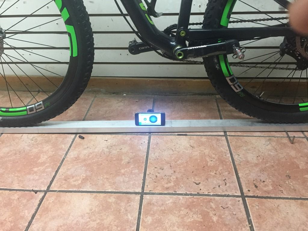

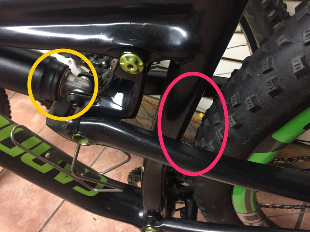

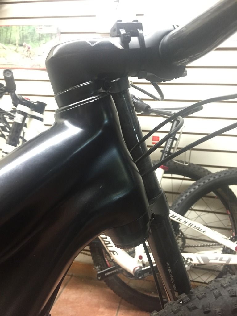

i did put an offset bushing to my 2013 scalpel. Also installed the headtube spacer from top to the bottom part of the steerer tube.
bushing installed(both holes) to my old rockshox
level floor. poor picture.
angle after install(90-20.7 =69.3)
slacker HT angle, lower BB. that's the immediate effect of it. No rear tire rubbing against the seat tube. Do i feel any difference? any advantage? I have not been riding really aggressive lately compare to when i have not done any "HT slack-hack" to the bike so cannot comment on that yet. And if they are right about the advantage of a 69deg HT, I have a reason not to buy a new bikeyet. not just yet.

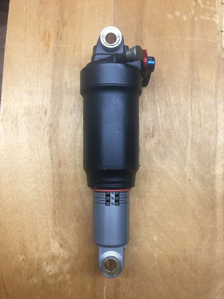

I've ordered one of the 6mm (0.75 degrees) bushings for the front mount. (Fox CTD) I didn't bother with one for the rear. Pretty sure only a 10mm will fit. (0.25 degrees) Not worth it IMO.
The bushing in addition to flipping the spacer from the top to the bottom should improve on slacking the bike out a bit. Not sure if I'll even notice though.....whatever

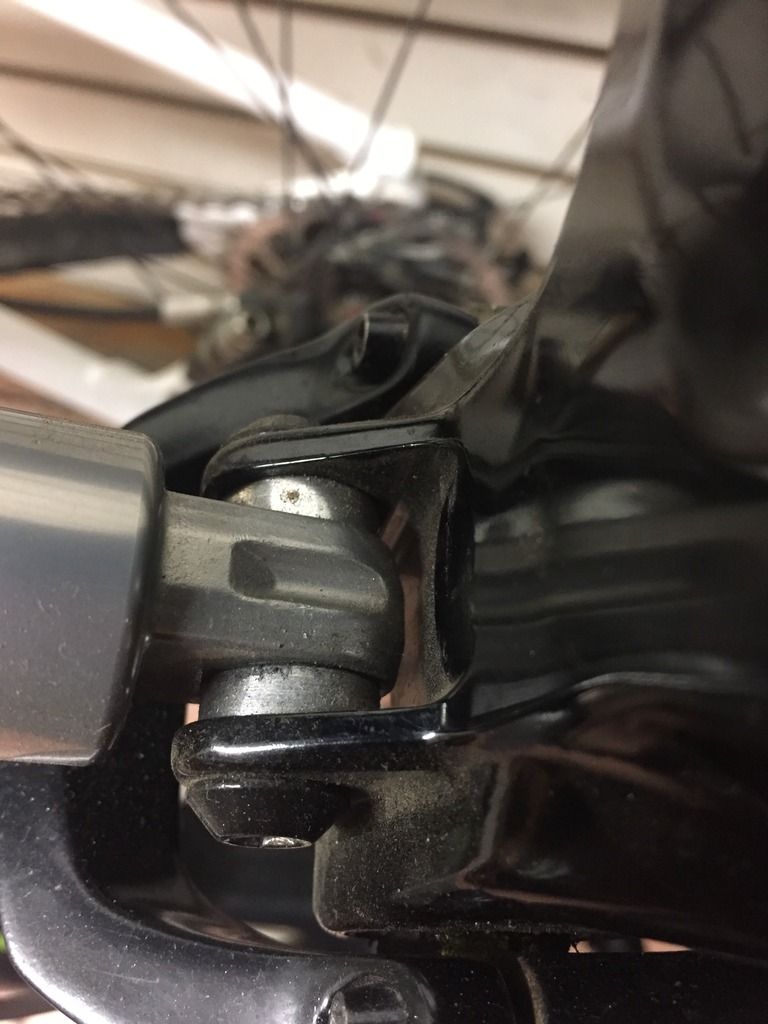

I was of the understanding that the stock bushing holes are centered (no offset)
6mm diameter - 3mm offset each, ~ 0.75° head angle adjustment.
8mm diameter - 2mm offset each, ~ 0.5° head angle adjustment.
10mm diameter - 1mm offset each, ~ 0.25° head angle adjustment.
A 3mm offset looks like it might be too tight

Yea....my bad......I just checked on my order.
They shipped the 8mm which will produce a 2mm offset.
I'll have to see if it will fit on the back of the shock. Looks pretty tight. If it will clear safely, I'll order another one
