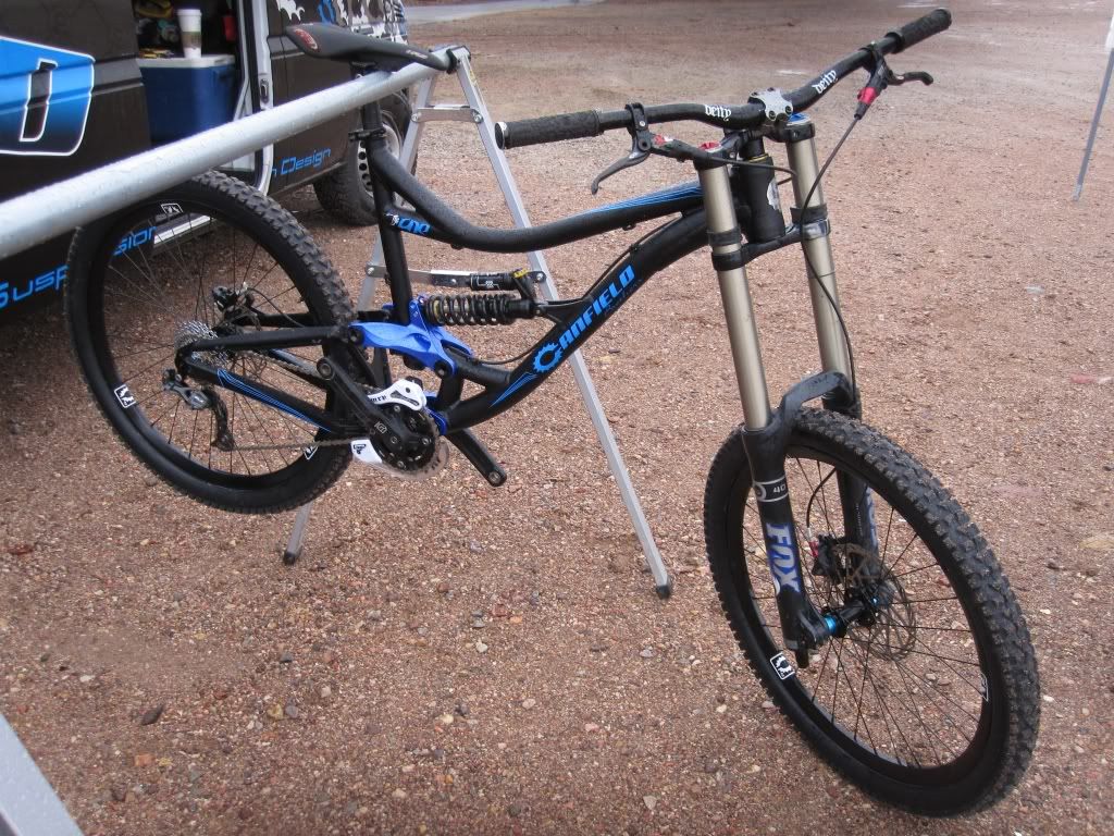

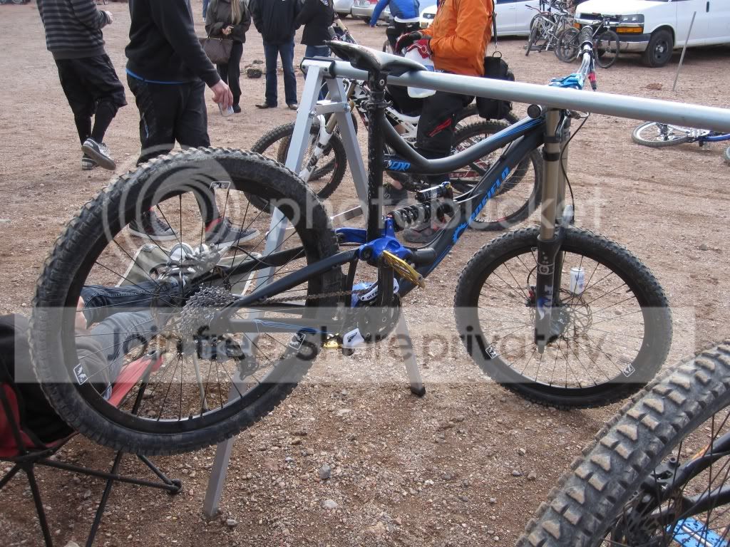

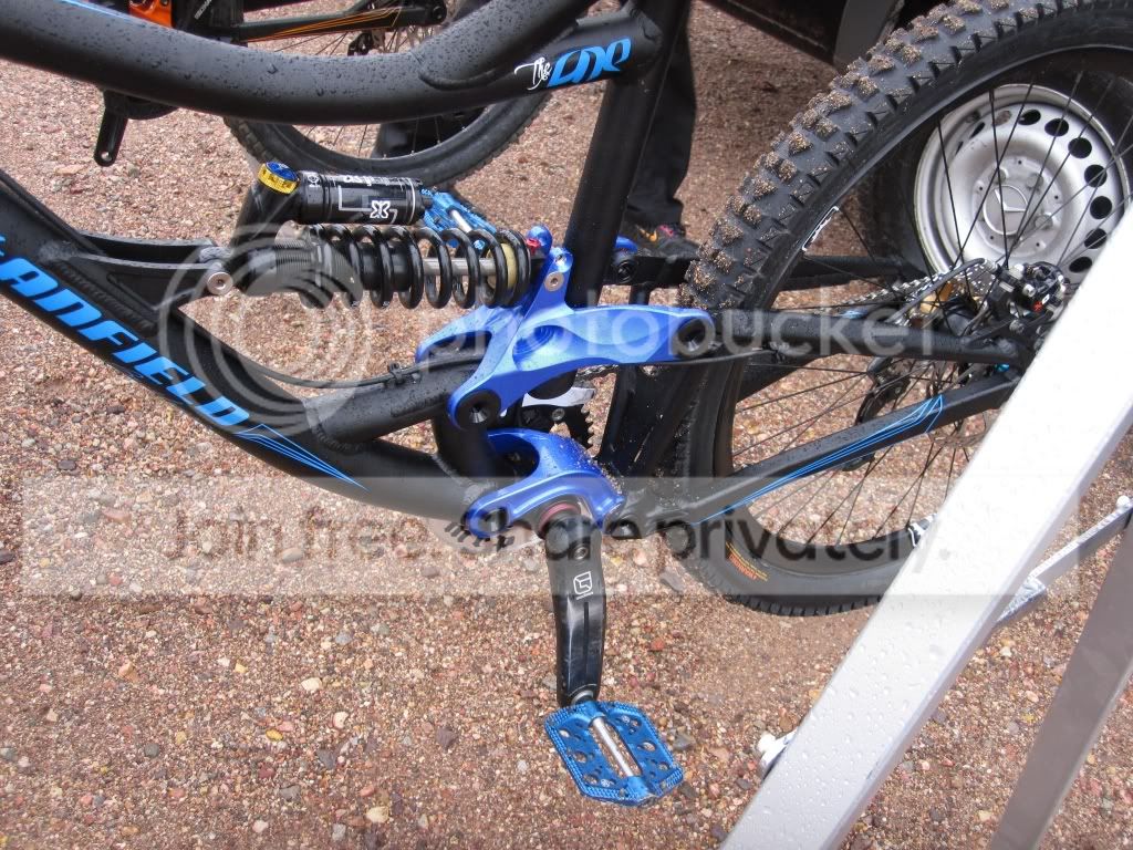

Whats the shock mount kit size for the frame? - I guess thats the only missing info.
Anyway, some pics to complement this thread:
