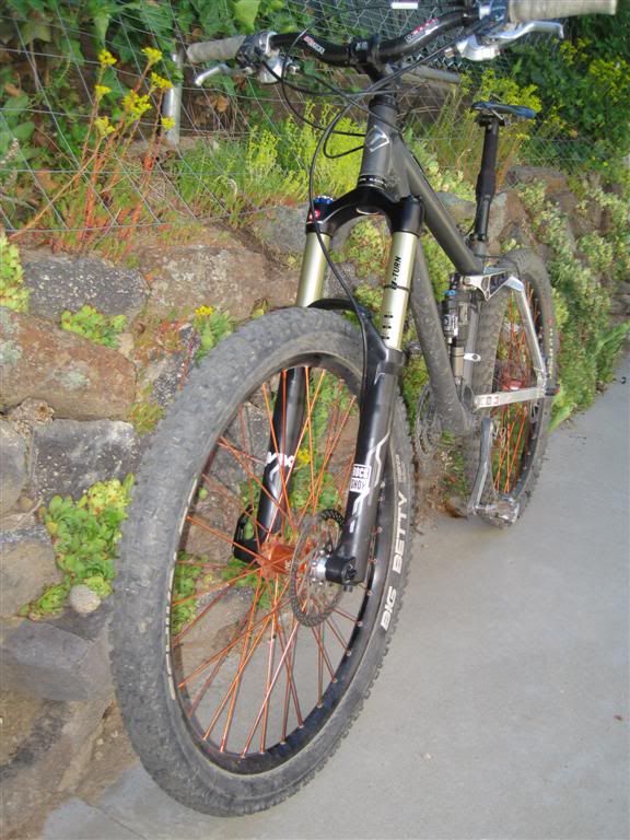

I just bought a Lyrik U-Turn from a fellow homer. However, the soft (yellow) spring is still a too firm for my taste. And yes, I already did an oil change in the damper and lowers but I'm still running LSC and HSC wide open (floodgate all the way open as well) to get this thing feeling less spikey. Although I tune based on ride and not by sag, I'm only getting about 15mm to 20mm of sag. I'm thinking an X-Soft spring is in order and maybe a 2.5/5 wt mix in the damper... Anyone know of a place to get X-Soft Lyrik Coil U-Turn springs?
Of course, the gratuitous shot... 30.2 lbs

very light build,nice polished rockers. which seatpost is that, and do you have any thoughts about the precision cycling components seatpost?
I think the blending of oil is the right way to go. I have the soft spring and still

I have the AMP and love it... Dead simple and reliable... Mark has the GD and his works equally as well and is simple as well. I still have reservations about using a hydro post on my all day rig so I'm staying away for those (plus, they don't make them in 27.2)
