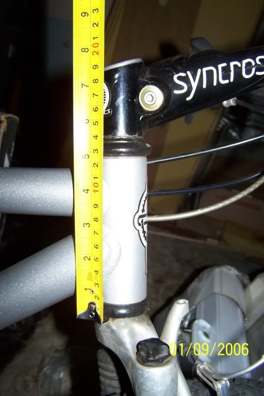

As far as which fork, there is a significant travel difference (100mm vs 130mm) between the Recon and Drake (not a Marzocchi fan). Also, a 180mm steerer on the Recon is pretty short. So look at those factors with deciding. Otherwise both forks are very good.
I'm leaning towards the Rock Shox, I picked up a new stem with a 40 mm stack height and I am going to get a new headset that is a little lower profile than the one that is on there. I think 180 should be fine on my bike, a 2nd set of eyes always helps, think the 180 should be ok, right?
Yea, that should work. Crank Bros Headsets have the shortest stack height BTW
