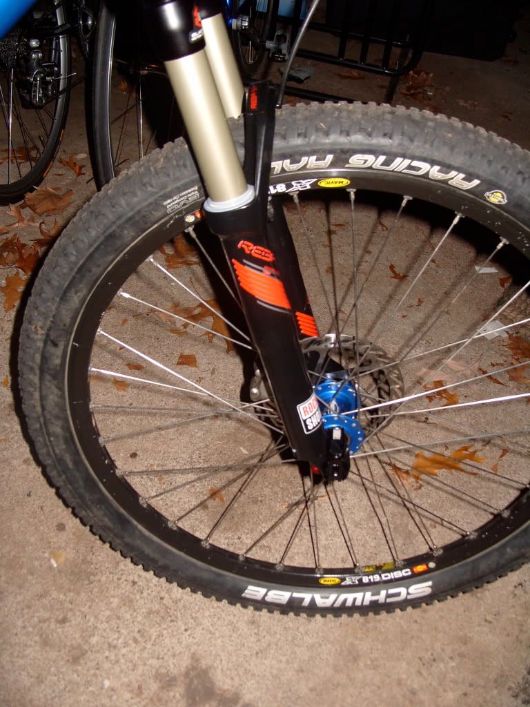

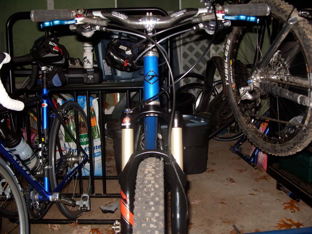

I decided to get a closeout Flux frame and new fork (thanks Chad and Dave!) and build up a bike for endurance racing and the occasional ride on the few XC type trails near by. Aside from the fork and stem the parts were all lying around. Clearly the crank is obviously a candidate for replacement but the 34 tooth middle ring works ok. Fork feels great and the maxle light works for my fat ar$e. I had a 29er Reba that was a wet noodle in comparison. I have the fork set at 120mm to experiment. I haven't weighed the bike yet but based on some build weights posted here recently I an certain it is lighter than my Pinarello road bike with Zipp 404s. I will likely take out one more spacer and cut the steerer at the weekend. I am keeping the wheels too. Although heavy, one flat in four years of riding 819s has me sold. I have tried DT Swiss and Stans rim strips on other rims and hated the results. Pics and build spec below.
Frame:: 2008 Turner Flux, Large, Candy Blue
Rear Shock :: Fox RP23
Fork :: 2009 RockShox Reba Team w/pop lock
Brakes :: Avid Juicy 7s w/Dangerboy Levers & 160mm Rotors
Cassette :: Shimano XT 11-34
Chain :: Sram 990
Crankset :: Shimano Hone 22 / 34
Derailleur (Front) :: Shimano XT
Derailleur (Rear) :: Sram X.9 medium cage
Grips :: Lizard Skinz Lock-On
Handlebar :: Truvativ Team Carbon O/S
Headset :: Cane Creek Solos
Pedals :: Xpedo (300 gram don't remember the model)
Seat Binder :: Turner
Saddle :: WTB Rocket V Ti
Seatpost :: Thomson
Shifters :: Sram X.9 Triggers
Stem :: Ritchey Axis WCS 90mm O/S
Hubs :: Hope Pro II
Rims :: Mavic 819
Tires :: Schwalbe Racing Ralph 2.2s Front & Rear
Moosehead

very nice, interested to see how you like the 120mm setting. if the reba drops down easy to 100, definitely check it out for fun factor espec compared to your spot and niner. are those slick dangerboys fit specifically to the juicy's or are they more of a universal fit?

I bought the dangerboys 2-3 years ago and they are specifically for avid brakes..at the time you could get them for most brands but I think they are out of business now. Straitline makes similar ones. The Reba is easily changeable to 100mm via internal spacers. I'll definitely do change the travel at some point.

The racing Ralphs are good in the dry and have massive volume - wider than 2.35 high rollers and 2.4 mtn kings (which are useless IMHO) but they aren't so good in the wet or mud. High rollers are my favourite UST tire but for the Flux I'll probably try ignitors or advavantages. I love mavic UST rims but I don't like their hubs- I don't think they make aftermarket UST rims lighter than 819s?
