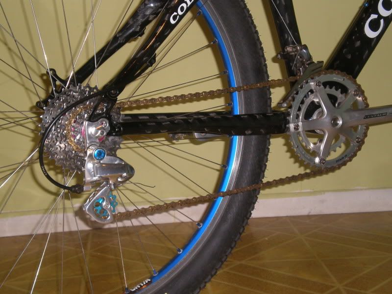

Its a no-brainer for me...
...the shiftng performance of this setup is outstanding compared to the triple.
Dura-Ace derailleur
Campy road triple crank with big ring removed
40 / 28 or 42 / 28 gearing depending on the course.
