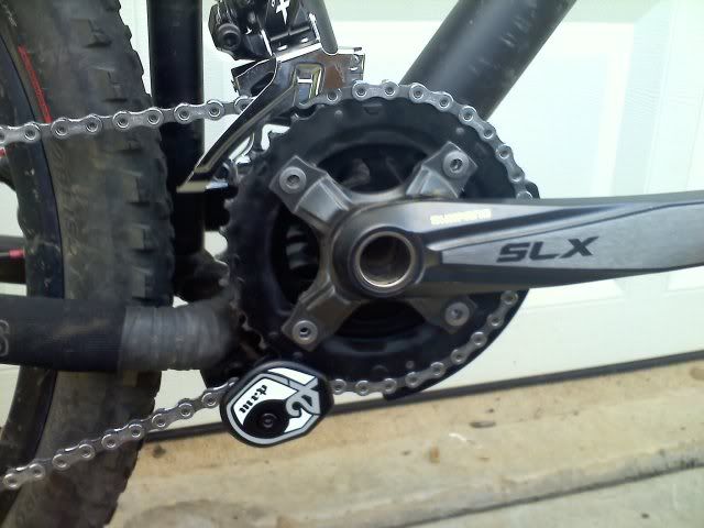

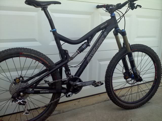

Finally someone came up with a 2 ring chainguide that fits the BLT2 with NO SAWING OR HACKING!!!!
MRp 2x chainguide 36-38T verson. Works with 9 and 10 speed cranks. Fit Note: requires TWO 1mm spacers between the guide and the backplate for clearance of the lower link but the kit only comes with One 1mm spacer so source another from your lbs before your chainguide arrives to avoid any unexpected delays. MRP has A +++++ customer service, so if you have any questions they are very quick to get back with you.
Rest of my Rig:

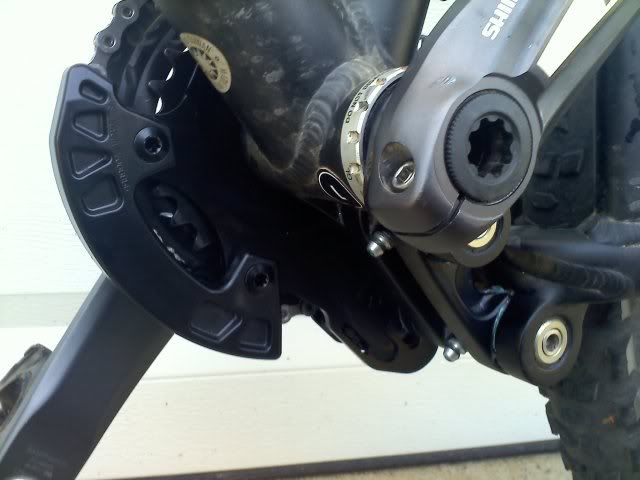

Is it possible for you to throw up some pics of the guide from a couple of perspectives? It's nice to see it on bike, but maybe what you said can be better visualized w/o the frame in the way? Thanx.
GUIDANCE COUNSELOR
3,844 Posts
Illustrating the wear plate's vertical protrusion.
Compared to LRP. Keep in mind that the chain will ride up on the LRP's roller and down on the 2x's pulley teeth. Also note that the LRP's back plate is sharp and exposed, and the 2x's is flat (the wear plate is taller).
It's not hard to make a guide that will fit every bike on the market - it's IMPOSSIBLE. That said, we've gone to great lengths to increase compatibility on the 2x vs. the LRP (most notably the smaller space requirement of the tensioner mechanism and the captured and flush hardware).
