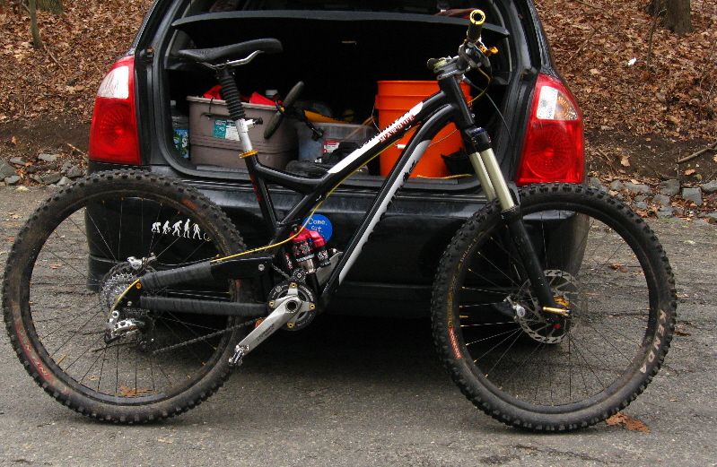

I've got a Corsair Marque built up, that I'm enjoying very much. The stock Marzocchi Roco (supposedly tuned by Marz for OEM spec on the Marque) works well, but is a pig, and getting to the piggyback res to adjust it at all involves removing things. A pain in the ass.
Thoughts on how to get something from the Fox Float or Rock Shox Monarch line to work decently? I've used some of them in the past on other bikes, and liked them. They'd dump a big chunk of weight, get rid of the piggyback access issue, and still give me the performance I'm after, in theory. I've actually got a Monarch 4.2 in the house of the proper size. I've tried it, and everything was just too sloooooooow.
As well, I've e-mailed PUSH to see what they think/if it is something they can do for me.
I'm about 165# all loaded up on the bike. 130mm travel out of a 63mm stroke shock. 8.5 i2i.

I just find it irritating to be locked into one option. Obviously not a deal breaker, since I bought the frame, but still... If I can get one of them to work, then that's a half pound right there - the bike is a pig. A very well pedaling pig, but still a pig. Particularly if something can be done with the Monarch that I already have anyhow. It's as light as it's going to get withoutme spending stupid money, or giving up/compromising on some of the stuff on the bike I am not willing to, like the Gravity Dropper post.
IMO, if they are going to leave you only one shock option, they ought to have given a bit more room on the downtube in order to not have to remove the shock to air up the piggyback reservoir. Not that I'm messing with it now, after getting it dialed in, but IMO, it's still not good.
IMO, the RP23 and Monarch 4.2 I've used in the past have worked and felt great, so I don't feel it would be any performance loss anyhow.
(really, i'm just *****ing. the build is two pounds heavier than the prior frame, with near all the same parts. the frame is not what i'd call "svelte" by any stretch. rides beautifully, though. :)
