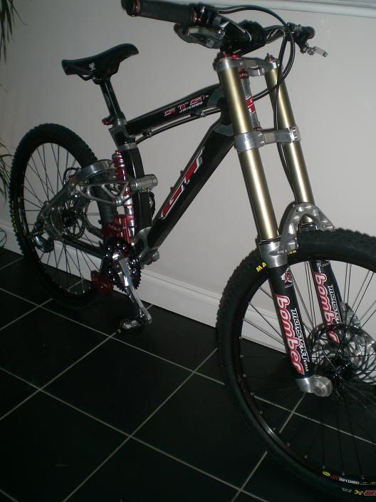

Here's a few pics of my recently built Lobo. Sourced an unused frame and it then took me months to source the parts. Labour of love for one of my dream bikes BITD. Yep I know they're prone to breaking and there's far better modern builds out there BUT building this has taken me back 10 years to when I had no wrinkles or grey hair
Here's the finished spec and a few pics

Although the frame was mint the existing decals had gone brittle with age and had started to flake. Had a new set reproduced which are pretty damn good copies, not perfect but good enough. The frame had to be 'tweeked' for the rear hose guides. The existing cable guides were given the Dremel treatment and a set of Hope Hose guides fitted. Got a few little jobs to do. Extend front Brake Hose, fit rear cabling, fit chain and setup chainguide.
Slight problem though. Far too nice and mint to ride in all this winter mud and snow :nono: so it'll be kept for the Spring Sunshine
