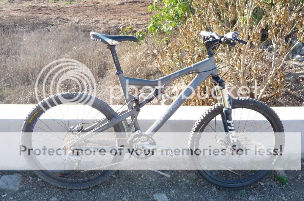

Hey guys, just picked up a 2008 5.5 evp frame that I built up quick with parts I had lying around. I was mostly riding a steel 29er hardtail and I had a Heckler that I never really warmed up to. Got this 5.5evp and I really like it so far. It feels quick like an XC bike, not clunky at all, and it works great for seated climbing. I had a question about the maximum travel for the front. I'm using a Pike coil that's dialed down to 130mm because I was under the impression that it took a 100-130 fork. I also have a 36 TALAS (which was on the Heckler I mentioned). I could adjust that travel down to 130 also. I'm thinking of switching to the 36 because of my weight (between 240-250 lbs). But just in case I keep the Pike, is it okay to run it at 140?
Oh, and here's a pic of the build:

When I had my 5.5, I initially had it set-up with a Minute 2 (130mm). It always felt skittish due to the steep HT. Later, I installed an '07 Fox Float (140mm) and IMHO, it felt like that was the fork that the 5.5 was made for.
I'm not sure on the axle to crown measurements between the RS Pike and Fox forks, but you should be totally fine with the Pike on there at 140mm.
newless cluebie
537 Posts
HA looks really steep in that pic for some reason, but it also looks like you're on a slight slope downward too.
119 Posts
looks steep because the crown offset is small.
I run a 32 TALAS on mine and it feels juuuuuuust right. :) and the offset is larger than your Pike.
IMO you should put the 36 on there and run it at 140...except on the climbs, that is.
You also may consider a crown race for a slacker HA.
