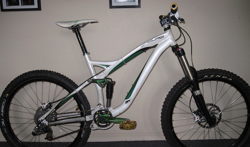

here's mine with a 2006 fox van 36 rc2:
2008 totem solo air:
2010 revelation dual air:
2011 fox 36 float rlc:
the totem was lowered to 160mm and was awesome. it looks like it belongs on the bike BUT it is 6lbs. the revelation felt a little small and was pretty flexy but it was 4lbs and felt pretty balanced on the bike. the van 36 was great as well, but it was just a loaner. the 2011 fox is new to me this month so i don't have any time on it, but it looks and feels awesome so far. it's the perfect compromise for the revelation as it is only half a pound heavier, but loads stiffer and has more travel.
yes, 4 forks in 2 years.

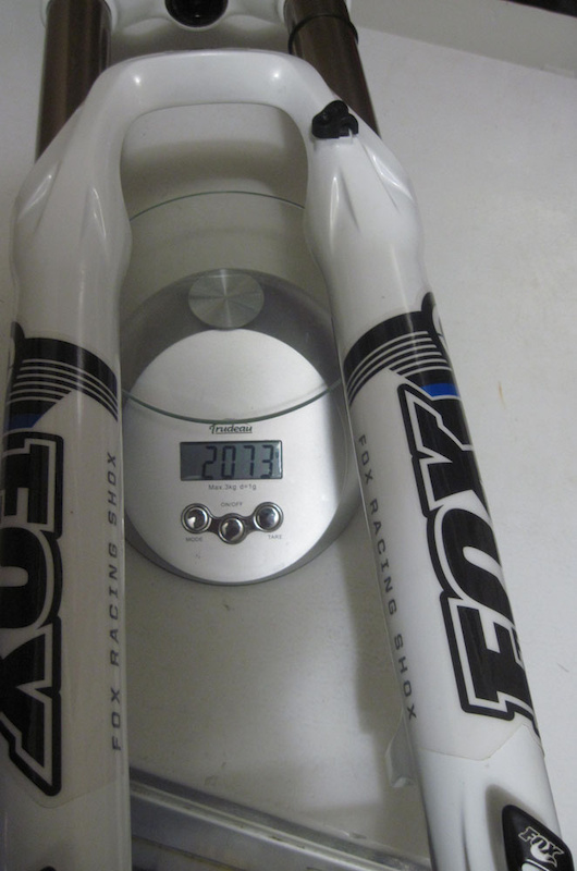

Looks like saturnine has lots of experience with different forks. As well as others suggestions I am leaning towards the Float 36. Any one know actual weights of there forks? My Talas 150mm is 4.4 lbs/ 1947grams.
Thanks for the weight. What rear shock are you using? Your pictures look like you have used at least 2 different ones.
Any opinions on best price for a Float 36 or Talas 36 since I have found it cheaper and it is black. Just started researching prices and have found the 2011 Fox Talas 36 160mm for under $900 shipped. Cheaper than the Float's I have found so far. I don't need the adjustable rate but do prefer the black shock and cheaper price.
i am currently using a float rp23 after ditching the stock afr. check ebay for the best price. i got my 36 for $730 shipped. if you don't need talas, why buy it?
